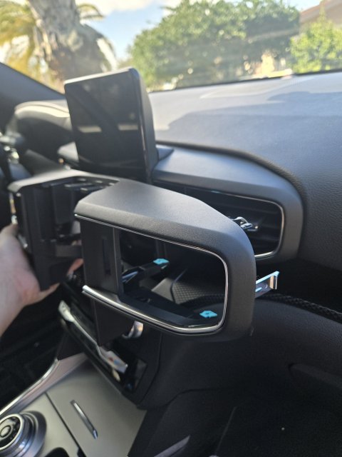

Part number I used was - LB5B-19F648-BC searching it looks like this part number includes the actual vents, where LB5Z-99018B40-DA is only the trim, you have to swap out the vents. That's what it looks like to me anyway. Searching around it looks like LB5Z-99018B40-CA is the 8" trim, of course do your best to verify that when you order.

Awesome, thanks for such a quick reply on it!!! That makes total sense they would have two part numbers, can't believe I didn't catch that in the exploded diagram i was look at!! Thanks!

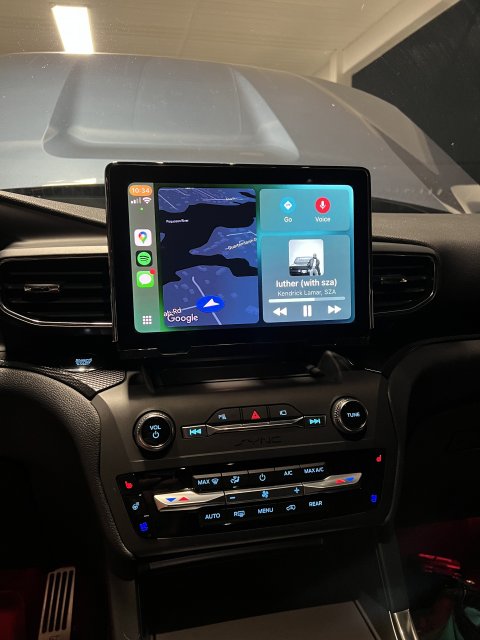

Got my screen from eBay and mounted it today with my custom fabricated parts. I ordered the lower trim piece from Etsy and it'll be here next month. Has anybody come up with the back vanity cover part number? My parts guy can't find it. He thinks it's part of the screen. I'll post pictures if anybody is interested. I switched from 10.1 portrait (factory installed) to 8" landscape and now 10.1" Lincoln Landscape.I didn't like any of them until I put the Lincoln screen in. I love this setup. Thanks to everyone who has contributed to this project.

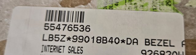

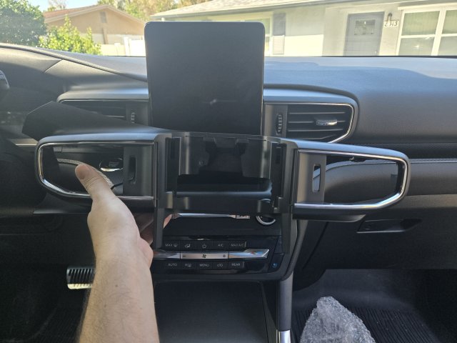

Finally got all my parts in, and I swear the part number for the vent housing that attaches to the screen is identical to the portrait housing... Hopefully it isn't because it was pricey. I went off this post and the list everyone has been using. If someone could lmk what I may be missing. Didn't have time to remove the screen to compare apples to apples...

So it looks like the CA is the correct and the DA is the 10in one. That was my mistake..

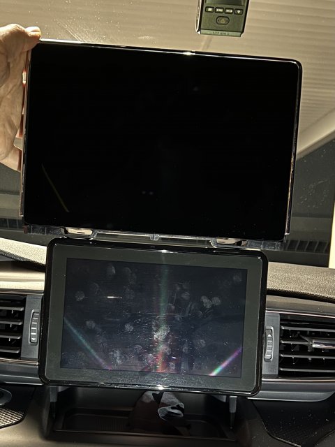

I'm looking for an absolutely wrecked Aviator screen....I don't care about anything but the top 2" of the housing including the chrome trim. The rest of it can be ran over by a car for all I care. Anyone have a line on a trashed screen?

Ok boys, just installed mine, but mounted with a zip strip at the moment. I’ve got some aluminum bar stock on the way.
you really gotta manhandle the cable because the Ford screen has the connector flipped the other way (there’s a little locking tab on the port), so I had to really work it to get it connected.
but wow, it’s an awesome difference even though it’s only 2” or whatever difference. I had the 8” screen from factory. The Lincoln screen just looks better. It’s bigger and more responsive. Honestly you have to see it for yourself. It’s no Tesla screen, and all the functionality is the same, but super nicer experience.

Does all that black part around the edges go away or no ? I thought it filled the whole screen . Is that incorrect ?
HoneyBadgerST
Cove City, NC
That black is the bezel around the screen. It's physically the same screen as the 10" vertical, so has the same amount of wasted screen around it.
