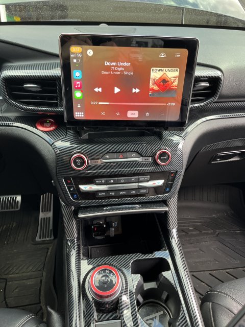

Wow. Your carplay fills up the whole screen... NICE.
181
54
Toronto, Ontario, Canada
Rear camera and 360 camera are full screen too which is incredible.

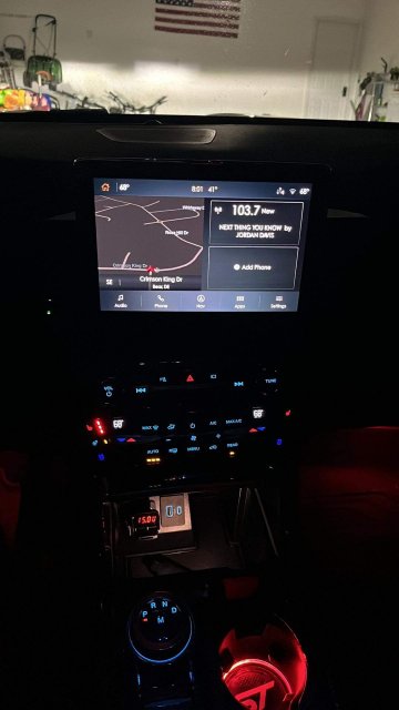

Can you take a pic of Google maps in full screen please. I jist want to make sure it takes up most of the screen before I pull the trigger on getting it. Thank you.
312
126
Bear, DE, USA
#26
yes car play and android auto are full screen that includes any app including any maps app. I don’t have a picture of it right now of google maps cause I use Waze exclusively.

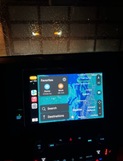

So correct me i'm i'm wrong but you're basically turning the 'normal' screen sideways. The Lincoln screen is 13" right? I looks good in the picture because the orientation makes sense when the screen is full. But having that much screen sounds amazing!

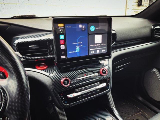

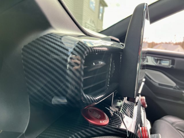

3d printed bottom trim cover from Haven3DDesign on Etsy arrived on Friday. Not bad considering it’s the prototype run so I’m sure there might be new versions coming soon of the trim cover. I’m happy with it for what it is!

#38
I searched Etsy and could not find it.
