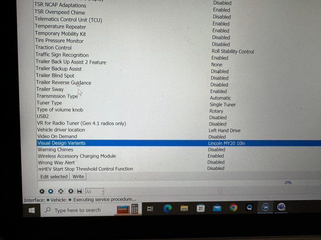

Finished my install. I switched to the 8" trim panels and used a square aluminum tube to make the brackets to mount it so it would sit higher.
2020+ LINCOLN AVIATOR DASHBOARD INFO DISPLAY SCREEN LC5T18B955UH OEM
2020-2023 FORD EXPLORER DASH CENTER AIR VENT GRILLE TRIM LB5B19F648BC
2020-2023 FORD EXPLORER STORAGE TRAY LB5Z7813546AC
Forscan was easy. In the APIM change 'Brand' to "Lincoln" and 'Visual Design Variant' to "Lincoln My20 10in"

Would you post up forscsn codes
Apim xxxx. Xxxx xxxx
Or did you go in the easy mode
And if you stay with vertical screen...how does lincoln setting change layout
It’s in easy mode, and with the vertical screen the Lincoln mode won’t work.
