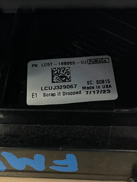

Is there any chance you can pull off the back cover that you notched and give me the number on the sticker or send a picture of it? That will help finding the part. Thanks.
Sorry, just saw this, haven't been on in a while.
Pretty sure this is it - LC5Z78042A82AA

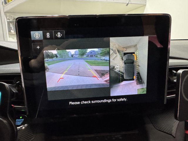

Has anyone figured out what Forscan settings to change to maximize the backup and 360 degree camera settings on the larger screen? When you look at the factory Aviator camera image compared to ours after the install, you can see that without other changes besides the previously listed ‘visual design elements - Lincoln My20 10in’, the camera is not taking up the full space like the factory Aviator image attached..

I'm pretty sure thats how they've all looked? Unless i'm seeing something different...the picture has been the same on the others.
Thought until you mentioned it, the fit/aspect does seem to be off. They all look like yours but it's deff different than the aviator factory. Maybe an adjustment everyone can benefit from?!
He's right. You can see black bars to the left and right of the camera images. (NOT the bezel, but "light black", from it being the LCD)
You can also tell from the warning writing at the bottom. Notice that on the Aviator, the writing ends to the left side of the 360 view because the video is so tall, and the Explorer shows the text across the entire bottom.
I don't know if there is a setting that hasn't been set, or not, as I've never looked into it, but it certainly needs adjusted

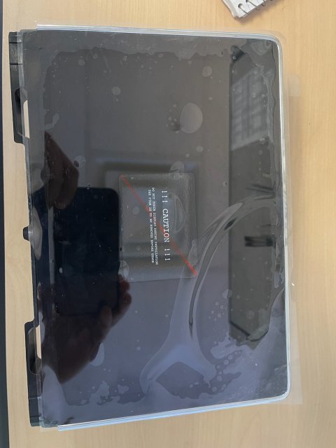

Cool. I'm interested. I've seen a few on eBay but not sure if they're correct. There seems to be multiple part #'s. I'd rather buy one from someone in the community than a random company on eBay. Can you send pics & specs when you get a chance. Thanks
Here are a couple pics of one of them I have.
I'm going to try to look through Forscan to see if i can identify any sections that may maximize the camera screen usage, but my laptop I use is very old and unstable, occasionally crashing/powering off, mid scan. If anyone else is feeling ambitious, I'm sure one of us could uncover the setting that will maximize the camera screen usage like in the original Aviator..
