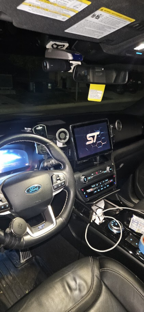

Something like this? When you turn off the car this is what it shows. Now I have a Ford Explorer ST/ Navigator
You can change the startup screen in Forscan

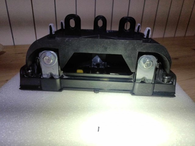

Here are a couple pics of one of them I have.

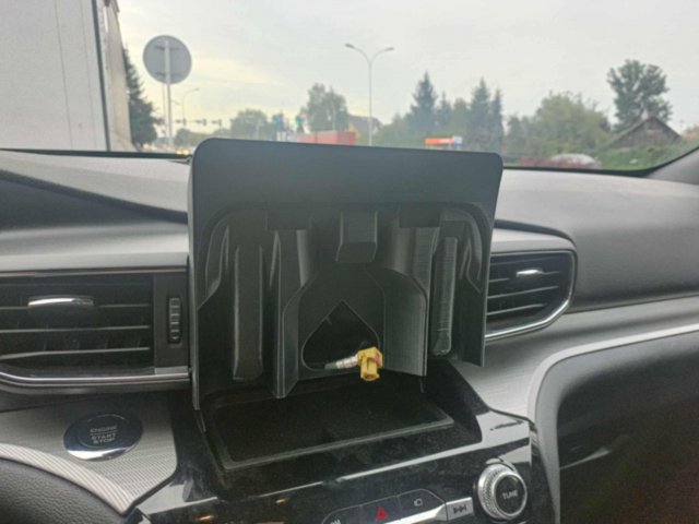

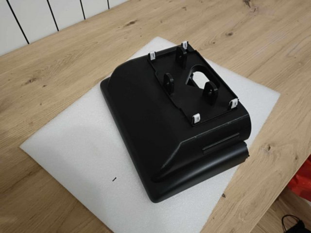

I saw this mount from a guy in Poland on a FB group and just happened to save his name. I can’t find the post again but has anyone else used it? It looks amazing and he told me $215 shipped which is almost too good to be true but whoever ordered it on FB seemed pleased.
Has anyone else seen or used it? IMG_5233.jpeg IMG_5234.jpeg IMG_5232.jpeg IMG_5235.jpeg IMG_5236.jpeg IMG_5237.jpeg
