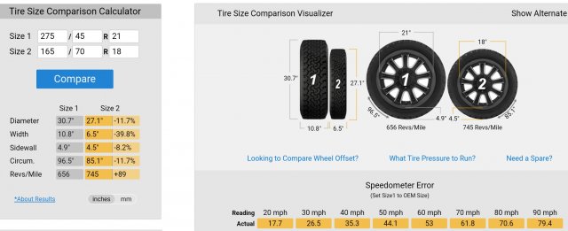

Makes me wonder, do one need a bigger spare tire?
Or, does a full size fit in there?
Especially if you are going somewhere, where you can't replace the original size, faster.
The difference is big.

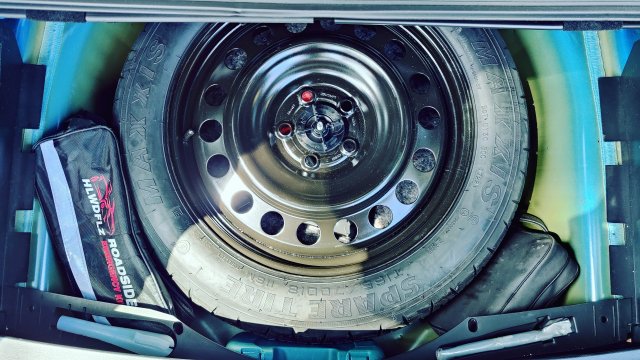

There is space in there to fit a bigger tire (after removing the inner load floor), but issue will be a cross member regular explorers have, for the third row seats.
Interceptor spare. (not sure of the size.)
My spare location (sorry, the cross member not visible in my photo)
I dumped the tool kits and inflator in there, before putting back the two load floors.
