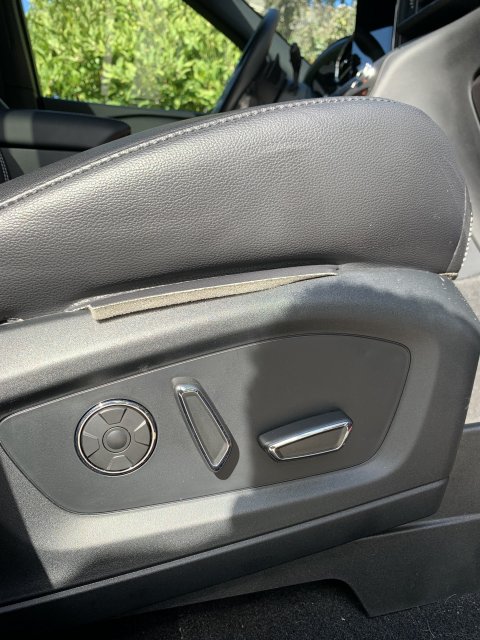

Yes. It starts with the side leather panel creeping up above the the plastic panel.
Took min into the dealership and the replaced the panel and the clips that keeps everything together on warranty.

The fix was replace the faulty clips and to mount the side plastic panel higher.

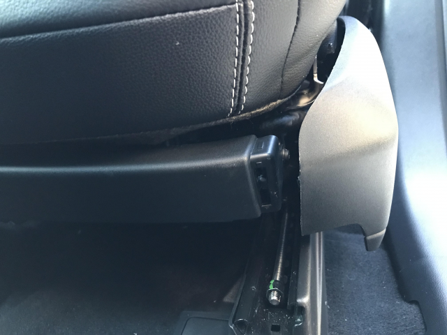

I've used a Frank T, Grimsby, ON, photo to show two areas where the mold-in clips, on the inner side of the panels, break. The center inner clip is attached to the seat frame. When entering and exiting the vehicle, body weight, on the outboard side of the seat cushion, forces pressure onto the lower panel and will break the flimsy, center mold-in clip. Consequently, the flimsy, front mold-in clips of the panel, also attached to the seat frame, break as well, unable to support the panel assembly. This lower panel houses the seat controls and after breakage you are left with a disassembled seat panel, that clearly show the broken clips. Breakage on my unit has occurred 4 times; very poor design but Ford does not recognize it being a problem. I'm not overweight but clearly enter and exit my ST very carefully!

2020 Explorer ST Lower Seat Panel - Below is a picture of a broken driver-side, lower seat panel. With entering and exiting the vehicle, downward seat cushion pressure snaps the flimsy molded-in center clips and the flimsy forward clips. You can clearly see where these clips insert into the seat frame. This renders the lower panel useless. Apparently, Ford does not see this as a problem according to my dealer. Although, breakage of the same panel has occurred 4 times. Buyer beware!

I don't know if your seats are constructed differently but I pushed down hard on both passenger side seat and drivers side--there is minimal or no pressure applied to the plastic trim at all. The seat cushion is pretty firm and it almost feels like there is a solid floor before any pressure gets transmitted to the trim.

Maybe earlier build date vehicles have this problem?

My understanding is the side panels were somehow mounted lower than intended. The fix was to replace the clips and mount it higher. So far it seems to be working on my explorer.
