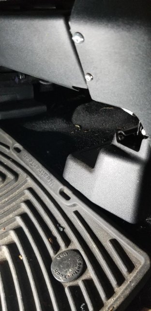

Explorer driver seat trrim.jpg My wife's 2020 Explorer's driver's seat trim just broke last week. I drilled a couple small holes in the front of the plastic trim and put a couple small bolts, washers and nuts thru the steel slotted area on lower seat frame. Seems pretty solid and with all the issues people are having I don't know if it would make sense to replace the piece if it's a recurring problem. I see the part on E Bay for about $40.
