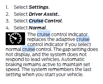

I have not tried this but to the cruise control
You can also switch to the traditional cruise control setting without Stop and Go by going to the information display, selecting Settings and then selecting Cruise Control.
Oh very cool, thanks for that info.

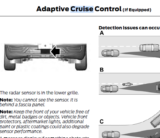

pg 254 . Also regarding clearing the camera and sensors, there is a small pic on page 249, the sensor seems to be near the license plate (2nd pic). Thank you for the report, very interesting,
