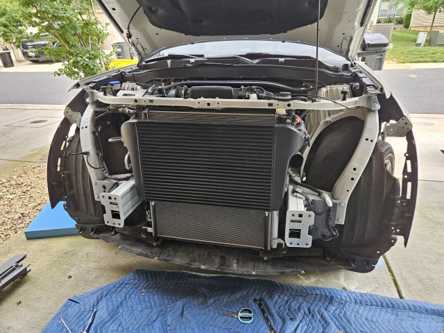

Not my pic, but looks like I won't be the first to install this.
Another person said they've had it for a few months with a tune, no issues. Their dragy was in the usual expected range.
I just found that I have a bad driver CV axle and the front axle disconnect actuator leak. Intercooler install will have to wait until those are sorted out at the dealer in May...

I finally installed the ebay IC today.
It went pretty smoothly, nothing unusual for an IC install on this car. The only hiccup I had was that the supplied bolt for the MAP sensor was too short. I had a feeling that would happen when I compared the supplied hardware to the Mishimoto hardware. A quick trip to Lowes took care of that.

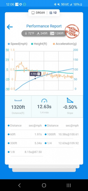

datazap.me | jwuonog | Explorer ST Quarter Mile 12.6
Here is a datalog of a Dragy run. I had just done a few Dragy runs prior to this one. It was 77 degrees, and 73.7% humidity. (I think humidity affects the IC's performance?)
You can click on different items in that link to toggle them. Look at Charge Air Temp and Engine RPM. You can see that the temps slowly climb during the run.
I think the brand name ones do a better job of keeping temps down over the course of a several-gear pull. My sample size is small, but I do think the other ICs perform better. My tuner has a CVFAB and I think his was doing a bit better over a quarter mile run.
If anyone has any datalogs with other intercoolers, that would be a helpful comparison. You can upload them to datazap.me.
Would I recommend it? I'd say it depends on your use case and your budget. It's is still a huge improvement over stock, and for my use case (wife's daily), I'm fine with it for now.
In my experience, the IC keeps charge temps about 10-15 degrees above ambient, except for very humid and hot days, it climbed a little higher. I haven't had it in colder weather yet.
