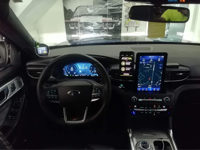

Vancouver BC
I use a Fuel-It bluetooth ethanol analyzer.

Vancouver BC
Theo what kit do I buy??? Looks like there’s a part that mounts to the fuel line
thanks
Hey man, thanks!
I used this kit:
https://www.fuel-it.com/bluetooth-flex-fuel-analyzer/
Tee off to the low pressure fuel line going to the HPFP, add power, and it's done. I also test the ethanol content on the E85 I buy then do the math to see if the gauge is accurate; it always reads a little lower.
It will always read a little lower. The sensor actually does not detect Ethanol, it detects the lack of Gasoline. So additives in both the E85 and Gasoline, will make the measurement slightly lower.
The measurement with the bottle if done correctly is definitely the most accurate.
