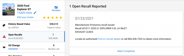

Saw this on CarFax after receiving an email "warning". I checked the NTSB site and there's no mention, and when I plugged my VIN into the recall checker on the Ford Owner site it came up indicated "None." Anyone familiar with this?
I'm curious because I've been noticing a very faint "chugging" sound on acceleration at times and I was wondering if this might cause something like that.

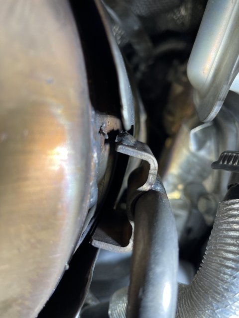

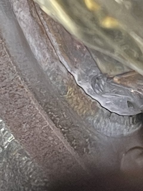

I guess this would be the correct thread to post on this. My 2020 had been rattling on startup and while driving for awhile, I looked at the flex couplings and the passenger side had broken, I think it was partly due to the hose clamp put on to stop the rattling. I took it to an exhaust shop, they put a woven flex coupling on and informed me my Drivers side Cat was starting to crack. I looked at it when I got home and sure enough it is cracked at the top side flange weld. Scheduled replacement with the dealership, no big deal…. This was 2 weeks ago…. This past Saturday I changed the oil and noticed the drivers side Cat mounting bracket weld has broken off and rattles like crazy, I looked all over the passenger side and looks solid. I dropped it off today to have the cat and the intermediate pipes replaced, received a call from dealer that drivers side is all done but have to replace the passenger side Cat due to a crack and will be completed tomorrow. Thank god for warranty! Pics are attached if anyone needs a visual reference on where cracks could be occurring. The pics are only of the drivers side cat, top flange weld crack and the lower mounting bracket. 8992D9FA-B95D-4DA9-AE7E-874191F62655.jpeg D5DB165C-4F3C-4785-8530-FF33642C5483.jpeg 961EA5B3-5C4B-4280-B5A3-AD40B4F5B6BC.jpeg

I guess this would be the correct thread to post on this. My 2020 had been rattling on startup and while driving for awhile, I looked at the flex couplings and the passenger side had broken, I think it was partly due to the hose clamp put on to stop the rattling. I took it to an exhaust shop, they put a woven flex coupling on and informed me my Drivers side Cat was starting to crack. I looked at it when I got home and sure enough it is cracked at the top side flange weld. Scheduled replacement with the dealership, no big deal…. This was 2 weeks ago…. This past Saturday I changed the oil and noticed the drivers side Cat mounting bracket weld has broken off and rattles like crazy, I looked all over the passenger side and looks solid. I dropped it off today to have the cat and the intermediate pipes replaced, received a call from dealer that drivers side is all done but have to replace the passenger side Cat due to a crack and will be completed tomorrow. Thank god for warranty! Pics are attached if anyone needs a visual reference on where cracks could be occurring. The pics are only of the drivers side cat, top flange weld crack and the lower mounting bracket. View attachment 8414 View attachment 8415 View attachment 8416
I suspect I have the same problem with mine. Which would explain not only the rattling noise but also the exhaust fume smell.

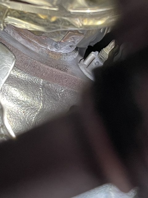

Had my LH catalytic converter replacement by warranty recall a year ago and looks like it needs another one according to the dealer. Making loud exhaust sounds on cold start, then settles down as it heats up. Noticeable again at high RPM. I thought is was only a leak at the gasket and clamp under the driver's feet area. This is what I was seeing. Dealer still evaluating the issue, leak vs full replacement again. Is this black spot normal, don't have it on the RH side. Dealer advised the CC was under warranty for 5yrs 80K , so I told them to proceed with necessary repairs. They are keeping it overnight. I think they will replace it all from the CC on down to the black connection. I think the CC may be an expensive item?

Yeah the OEM CC isn't cheap by any means.
UPDATE: Dealer also replaced the one shown in the photo above as a bad CAT. The next week I was back with a Bank 2, Sensor 1 (o2) message on my app and check engine light. Dealer advised P2240 and P2629 and replaced the sensor, cleared the check engine light, but the light and errors returned during testing. Next day, they replaced the same sensor again and it appears to be ok now. 1st CAT recall, 2nd CAT Emissions Warranty, the sensor covered with extended warranty. Rental car was offered but I didn't need one at the time.
