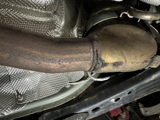

This the driver's side. I was under the car looking at something else when i noticed the crack at the weld. No smell, no noise. Some have it up by the flange but the same weld material is likely suspect throughout. Oddly, the recall specifically mentions the left side. Why wouldn't the right side be affected too? I'm asking because a recall will be performed under any mileage but if you are out of warranty, the right side won't be covered.

Our drivers side cat was cracked halfway around at the weld, replaced under warranty. While there, they replaced the oil pan, it had a leak at the left front of the pan. Did the PCM update and the parking brake auto on thing, no big deal, just touchthe gas and it releases.

Mine got worse and worse since the first year and at 3 years had my catalytic converter replaced on the driver's side. Now I'm happy to report no more exhaust smell even on cold days.
