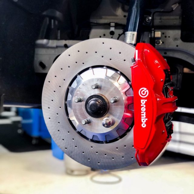

Brakes
If you run the Sport-Technology (ST) Explorer hard, and are tired of brake fade, you might want to look into a brake upgrade. Brake upgrades range from just a rotor and pad change, all the way to 8-piston caliper, 405-MM rotor brake kits.

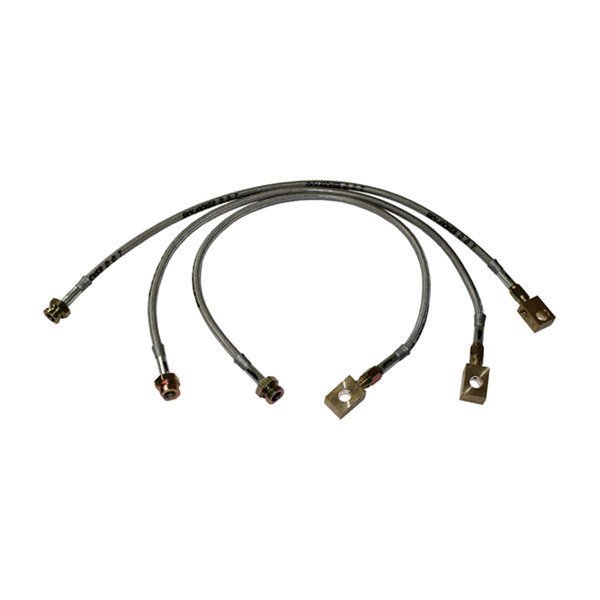

Stainless Steel Brake Lines
The best brake upgrade, whether you have a BBK (usually they should come with SS lines) or stock brakes are a set of Stainless-Steel Brake Lines. Stock rubber lines will swell and stretch when pushed hard, causing a mushy brake feel, diminishing brake feel, and poor braking. Stainless steel brake lines will not do that, and improve brake feel, and slow down brake fade.
Stock Brake Upgrade
PowerStop Z23
An upgrade is the PowerStop Z23 upgrade. It includes slotted and drilled rotors (which look neat behind the wheels), and performance pads. It is a great looking upgrade if you don’t want to fork over the larger price of a BBK (Big Brake Kit), but want some better looks. You will probably not see any brake distance improvements.

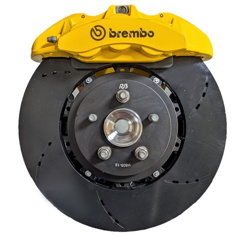

Big Brake Kit
BBK is going to be the ultimate brake upgrade, will eliminate brake fade, improve braking distance, and have a great brake pedal feel.
Shelby GT350 Front Brake Kit + Adapter Brackets
One of the best just-front BBK is the GT350 front brake upgrade. To work, this uses the stock GT350 6-piston calipers, 15.5-IN. rotors, and adapter brackets from Tony Hernandez on Facebook. It is a great kit for a great price, and costs just less than $1,700 if you use the GT350R brakes (which are red) and less than $1,500 if you use the regular GT350 brakes (which are black). If you are still using stock wheels, then you need to use 1” spacers, which isn’t all bad. 1” spacers will give the front wheels a perfect stance. Sadly, you can’t use the rear GT350 brakes since they aren’t compatible with our electronic parking brake.
GT500 Front Brakes + Adapter Brackets
Just like the GT350 Brake swap, the 2020-23 GT500 brakes will swap over very easily. Using the massive stock GT500 6-piston calipers, 16.5-In. rotors, and adapters from Tony Hernandez, this is an awesome upgrade, my personal favorite.
Trackhawk Front Calipers + Racing Brake Rotors and Mounting Hardware
Another just-front BBK choice is using Trackhawk Front Calipers and Racing Brakes Rotors and Hardware. This is comparative to the GT350 swap, but is probably $1k more. The rotors and hardware from RB alone WITHOUT the calipers is the price of the whole GT350 brake swap. It would be a good option, but the GT350 brakes are a better option because of the price.
SuperForged
SuperForged is the best choice if you want to go all out with a front and rear BBK. SuperForged’s brake kit includes 405-MM front rotors clamped by 6-piston calipers, 380-MM rear rotors clamped by 4-piston brakes, stainless steel brake lines, all the mounting hardware, and an 1-piston caliper for the parking brake (although there is a $100 option to integrate the parking brake into the caliper, which I assume saves unsprang weight). This kit retails for a fair value of $3,800.
Rotora
This is the ultimate bragging rights kit. Rotora has many options for BBK, but they all come at a price. All feature 8-piston front calipers and 4-piston calipers in the rear. The kit is just too expensive. The price for a front kit alone is the price of a front and rear Superforged kit. The performance benefit is not better either. In this case, bigger and more expensive is not better.

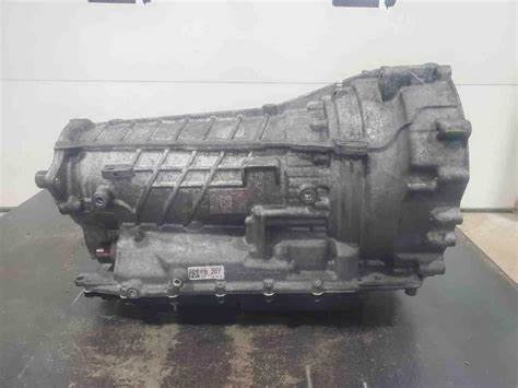

Built Transmission
The 10r60 is a pretty stout transmission in stock form, but if you are launching with a tune often or have a trans-brake, then you will need a built transmission. Getting a built transmission will give you the peace of mind of knowing that the tranny can handle anything you throw at it. RSA Transmission is highly recommended, and their work can be vouched for by the fact they hold the crown for the fastest ST with which they have done dozens of extremely hard launches on the built transmission.

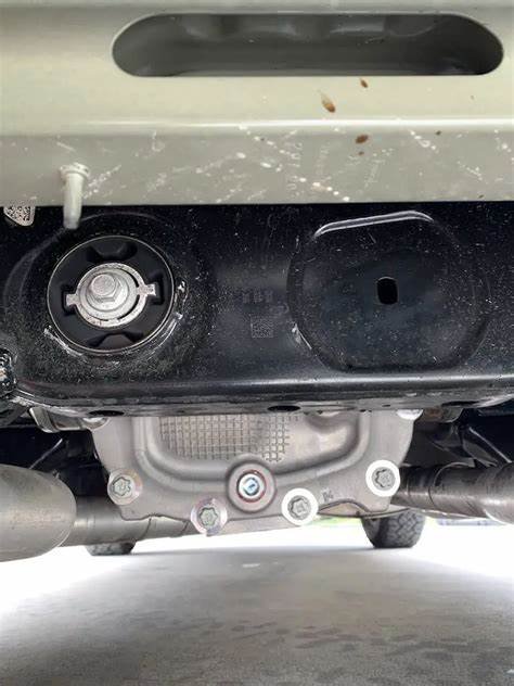

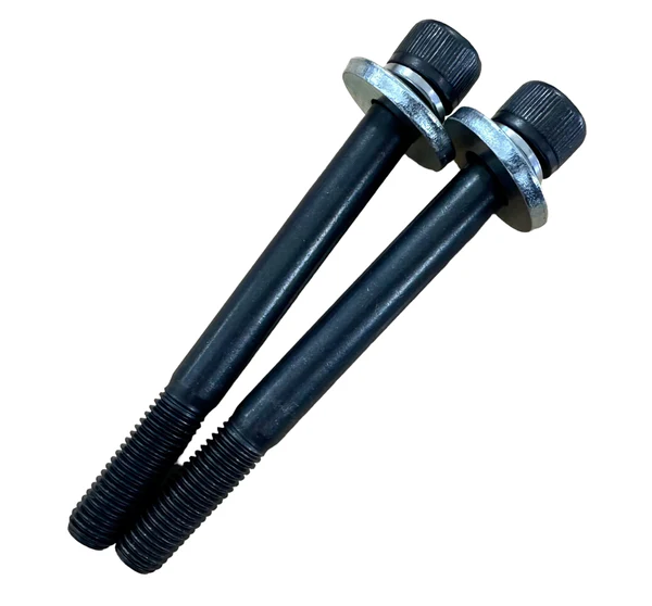

1-bolt Rear Subframe
In late 2021, due to supply shortages, Ford decided to put the 1-bolt subframe from the 4-cylinder Explorers into the ST. Bad choice, horrible choice in fact. The 100+ extra HP that even the stock form produces is too much for the subframe to handle. Even on mild launches, the bolt is known to snap, which can lead to a domino effect taking out the rear diff, shoving the rear driveshaft up the transmission and boom, you could have a cracked engine block. Not fun even with a warranty. So, if you have the 1-bolt, get a differential brace.
The good news is that with a differential brace, you will not have that problem. The best one, though the most expensive one, is the ID-Speed brace, but it is worth every penny. Launch away! Crazy that a little part can stop all those broken parts.
The 2-bolt alone pretty much handles anything you throw at it, so this is a peace-of-mind part. I would personally purchase it if you are launching a lot on a tune. Especially with a trans-brake. It just never hurts to be too careful.

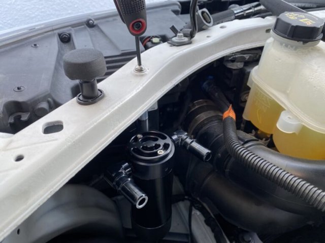

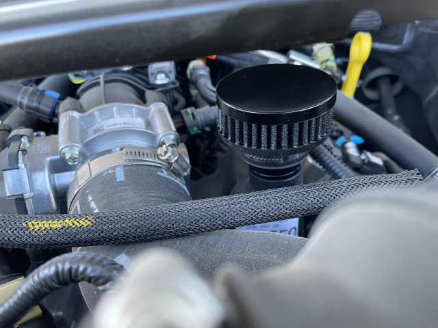

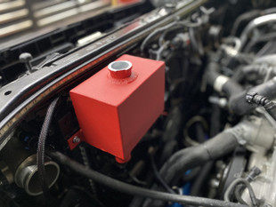

Oil Catch Can
A catch can removes oil droplets from air circulating from crankcase to intake. It is very important, and every 5k miles usually nets two shot glasses worth of oil that would have coated the valves, had the catch not stopped it. The best catch can that does the job perfectly is the UPR Catch Can, but it is 4 times the price of the runner up, the JLT 3.0. The JLT will do 90%+ of the job that the UPR will do, but at a quarter of the price.

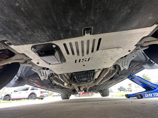

Ford Performance Skid Plate
Kind of an odd part for a street-oriented performance vehicle, is an engine skid plate. This protects the engine from being damaged by any objects from below. Ford Performance panned this part from the Timberline, and it features an easy access hole for the oil plug. If you drive trails/dirt roads or just want the extra protection, the Ford Performance skid plate might be a good peace-of-mind part.

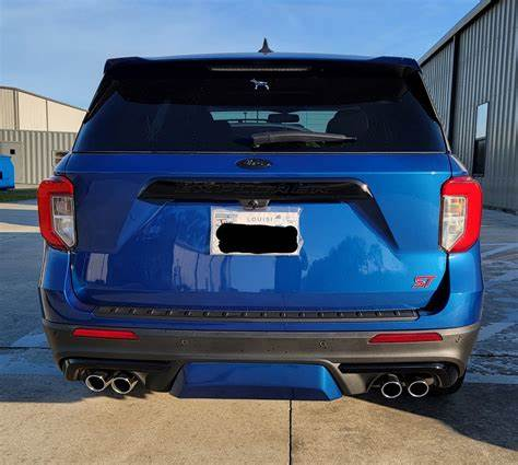

Exhaust
This part is highly subjective, as the “perfect” exhaust note depends on one’s taste. I will summarize this section.

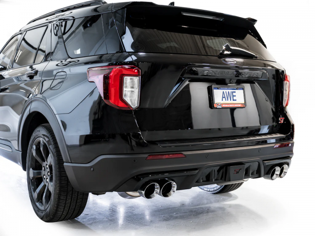

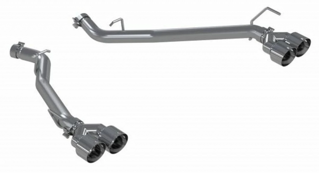

Cat-Back Exhaust
The stock catback, though extremely quiet, is actually not that restrictive. Upgrading to an aftermarket exhaust will not net a worthwhile gain if you are just looking at it for power, but sound and replacing the rattle-prone flex-pipes (which will rattle in the future no matter what) are the pluses.
Stock Cat back with Aftermarket Tips
If you like the quiet exhaust but want something better looking than the tiny 2” quad-tips that come stock, it is quite simple to make it look better. 3” quad-tips with a 2” inlet slips right on with no fabrication. It is as simple was cutting off the stock tips, and welding in or screwing in the new exhaust tips. I do not recommend screw-in type tips, as they have a good probability of falling off. 4” exhaust tips will fit with some fabrication, but you will need a 2.5” inlet so that you can properly space the tips. They will fit in the diffuser perfectly but are not as easy as just slipping them on.
Muffler Delete Axle-Back
A very cheap option is to do a muffler delete, and it sounds decent….but it will drone like crazy on the highway.
Resonator Delete
A resonator delete usually does wonders, as shown in the Mustang GT for example. But the res delete on these Explorer’s will give it a very slight sound improvement, but nothing you can hear inside.
Thermal R&D 2.5” Exhaust
This is the best exhaust for people who want some more sound when they step on it, but quite on everything else, the Thermal 2.5” Exhaust is the best choice for them.
Thermal R&D 3” Exhaust
The best all-around exhaust is the Thermal 3” exhaust. Zero drone, mild sound when normal driving, and awesome sounding on acceleration. This is the best exhaust for people who want to hear EcoBoost sing the best song it can sing.

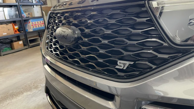

One of the things that is frustrating, is that the ST did not receive the black emblems from the Timberline, among other things (like a Torsen rear diff.). I love how a pair of custom emblems look. Emblem City makes a great pair of emblems if you are looking to go custom, and Ford Accessories have the Black emblems from the Timberline. The difficult part is you have to remove the front bumper to remove the emblem, unless you use @UNBROKEN ’s, which you drill the tabs out through the stock emblems. Once you remove the bumper, you will need to drill some new holes for the emblem, even with Ford’s ones. It is quite easy though, when you use the included templates.
A cool idea that @UNBROKEN came up with, is he removed the stock “ST” emblem on the grille and used an ST overlay to make it like a “ghost” emblem. It gets rid of the chrome too.

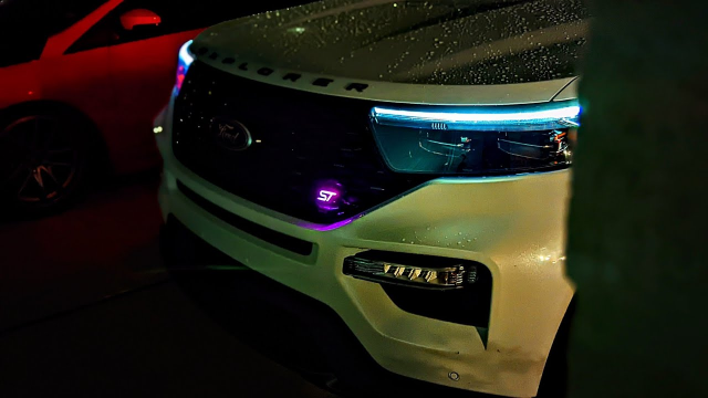

LED Light Strip
A cool modification is the addition of an LED light strip. It connects the bright DRL’s with a bright strip, which is neat.

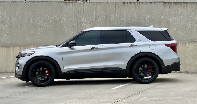

Lowering Springs
Lowering springs are probably my favorite cosmetic mod, but it also helps handling and paired with a rear sway bar it about wraps up the suspension department. Steeda, H&R, Lethal Performance, and now Eibach are offerings for lowering springs.
Steeda Lowering Springs
Steed’s lowering springs retain the factory “rake” of the suspension (rear is higher than front). If you tow any type of medium-large trailer or if you just plain like the look of the “rake” this is your best option. Steeda’s setup will give you more control over a trailer then other offering.
H&R
H&R is the best springs for looks. H&R was the first company to provide lowering springs for the ExST community and they are the most popular offering. They are a great springs and nothing but positive reviews for them. The advertised drop is 1.6In. front/1.75In. rear.
Lethal Performance
Lethal Performance’s springs are plagued with problems. You could be lucky, and not have any problems, but most likely you will have problems. They have squeaking problems, have been known to bottom out often, and some have even lifted the vehicle, the opposite of the purpose. The advertised drop is 1.8In. front/2.0In. rear.
Eibach
Eibach is the newest to the game, but their reputation precedes them. They have the most drop when they settled. In my opinion, these would be the ones I would purchase.
Coil overs
Coilovers look amazing, as they drop the car a lot. I do not recommend them though. The reason is, is when you drop it that much, it is very difficult to get it aligned correctly.

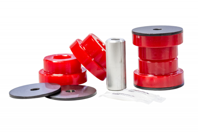

Subframe Lockout Kit (also known as Subframe Bushings)
A subframe lockout kit helps prevent the subframe from moving during hard cornering or launches, giving the car a solid feel, no wheel hop, and a connected feel when cornering.

Wheels
Who would have thought a 4,000LB. SUV could spin all 4-tires and run 11’s in the quarter mile all day long!? To put all that AWD grip to use, a good wheel setup is needed. Thanks to @UNBROKEN we have the perfect wheel formula.
The best setup is 22x10.5 et.30 wrapped in 305/40R22 or 305/35R22 rubber (the better available tire size). If you are going custom from the like of Vossen, Velgen, or others, this is the only way to go. Forged rims are what you always want to aim for, as they are lighter than their cast counterparts. The best-looking wheel is in the eye of the beholder so here are a couple threads that can help you choose:
