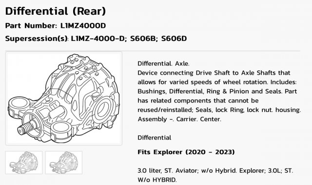

The part number for the ST/Aviator entire carrier is L1MZ-4000-D (to the best of my recollection), whereas it’s M1MZ-4000-TB for the Timberline.
The complete ST assy lists for ~$800 new, the timberline unit is $2500. The aviator unit that unbroken listed comes up with nothing.
I'm still curious to know what's inside the unit he scored. Is it a torsen or just a ford trac-loc LS differential, or even an open diff?

It’s not going to be a Torsen. It will be the same Aviator/ST diff. There are a lot of them on eBay for just a few hundred dollars. Just because the housing is the same, doesn’t mean the internals are.

Well…they got back to me and said they in fact did make a mistake. The Aviator is open. Oh well….wouldda been sweet.

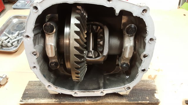

After a long time of the torsen sitting on my shelf I finally got around to attempt the swap. I got myself a used diff so I did not have to remove the diff from the car to try to swap the internals.
When the rear cover is removed it looks like this.
The gear is welded to the carrier.
