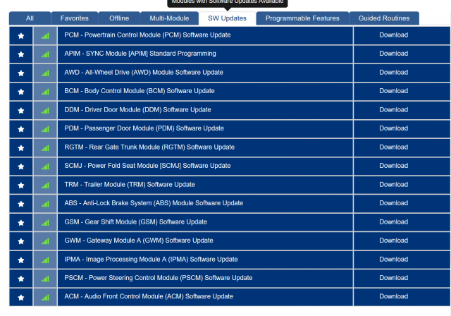

I took my Explorer in for trans issues back in July/August and they STILL didn't update anything. These are all of the updates my Explorer needs:

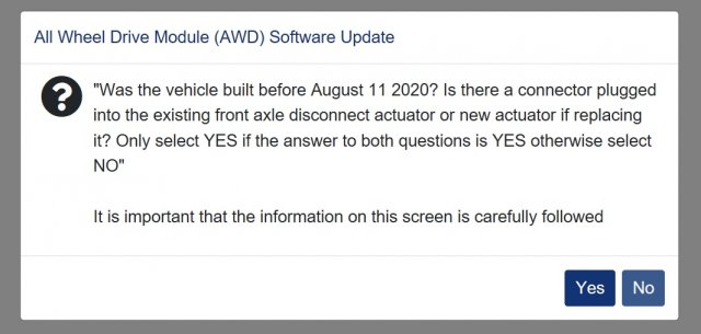

The only module I didn't update was the AWD module because it asked me questions that I could not answer:
1) was the vehicle built before 11 Aug 2020? (mine was built November 2019, so that was easy)
2) is the an electrical connector attached the to front axle disconnect actuator? (the question was something like that, I didn't write it down, but I couldn't find the front axle disconnector to even find an electrical connection)

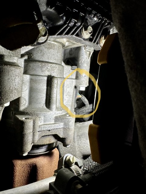

Maybe too late for you but you can check for the plug by peeking under the rectangular cover to the center of the axles. you just need to remove the two bolts and one plastic retainer at the rear corner to get a sufficient look. See pic of driver side. if the front axle disconnect actuator has a connector, it'll be on the front surface. they eliminated the plug altogether on newer ones.

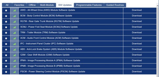

This was my list of updateable firmware, but the dealer did update a handful of modules spring 2021.
Took me about 4 hours to do the above (incl. checking for AWD question above) and re-do my Forscan coding (double honk, FENG disable, and LED rear turn).
