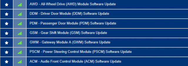

This was my list of updateable firmware, but the dealer did update a handful of modules spring 2021.
Took me about 4 hours to do the above and re-do my Forscan coding (double honk, FENG disable, and LED rear turn).

Yeah. The BCM removed all the BCM settings I did. and the ACM removed the FENG disable. Upon completion of the module updates, AWD and ACM still were listed as needing updates but both updates had completed successfully so just figured the servers just didn't update them? And I did have to open the liftgate manually the first time I tried to use it, but after the next keystart, it was working again. Otherwise no lasting unresolved issues.
