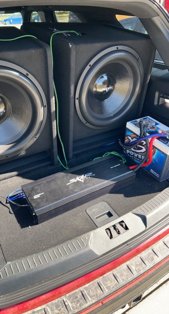

I have recently added subs to my Explorer ST. The biggest issue is when running your LOC from the stock sub/amp, to the new amp, there’s a considerable bass volume decrease when playing at high volumes. A bass knob will not fix this issue as I have one and have to constantly turn it up and down when playing at high volumes to 1) stop the subs from clipping and 2) hear the bass from the initial hit of the subs. I left my subs off the replicate with the stock sound system and it’s definitely noticeable.
Is there a way to take the signal from the stock sub/amp and make it so the aftermarket amp is not dependent on the signal strength it’s receiving from the stock system?
I saw somewhere on the forum that the stock system is trying to compensate for a bad stock sub by lowering the bass at higher volumes, I’ve also heard that the car is trying to compensate for the mic. I’m not sure what to believe but I’d almost pay anything to fix it. I’m just not sure if there’s something I can disable or buy to buy pass whatever implementation they’ve implemented to cause the bass decrease at high volumes.

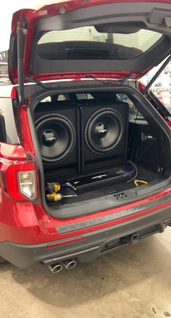

I should add, i took it to an audio shop near me to have them install everything being this is a new car and I can’t afford to mess up the wiring. They tapped into between the stock amp and the stock sub for the loc. I’m using a fairly cheap loc that has done very well in the past for me since all I’m looking for is base. I’m soon going to be downsizing my subs to 2 JL audio W7s since my trunk started to fall apart from these earth quake makers. Sound quality is really what I’m shooting for but I want to fix the issue of the bass getting quieter at high volumes before I even think about putting W7s in. I don’t believe electrical is the issue since I installed an XS Power D3100 battery with the stock battery. I understand things are run off of the Alternator when the car is on and plan to upgrade that in the near future.

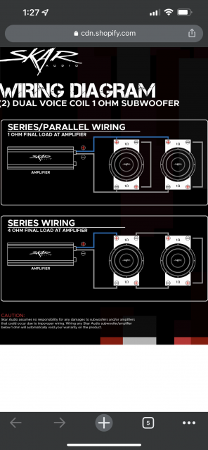

Just now, I was perusing some SKAR products. I have to say at least on paper, pretty impressive. Not knowing what you have, one of their sub amps claims to be 1 ohm stable. I did see a sub like the two you have pictured. It claims to have dual 2ohm voice coils--one ohm at the terminals. If you have two of those in parallel, that is 0.5ohm which likely is more than your amp can muster. Look into that. You might want to just run one of those and seeing what it sounds like.

Just now, I was perusing some SKAR products. I have to say at least on paper, pretty impressive. Not knowing what you have, one of the sub amps claims to be 1 ohm stable. I did see a sub like the two you have pictured. It claims to have dual 2ohm voice coils--one ohm at the terminals. If you have two of those in parallel, that is 0.5ohm which likely is more than your amp can muster. Look into that. You might want to just run one of those and seeing what it sounds like.
I followed their wiring diagram to get to 1 ohm. I have the RP-4500.1D and 2 ZVX-18v2 D1 1 ohm subs. I contacted ford today to ask about the issue and they recommended taking it to my local dealer so they can further assist me.
That is fine if you have each subwoofer wired for 2 ohms (ie. in series) and then run them in parallel to the amp.

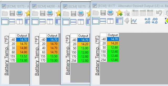

@TheCryptoTrain, and anyone else looking to get the most out of their audio system...
Attached is a screenshot of the factory Ford tables that dictate the alternators output. As you can see the target voltage drop WAY BELOW the ideal range for maximizing an amplifiers output. Once the assumed battery temperature rises, voltage plummets. I'd suggest seeing if your tuner can adjust those tables before paying for an upgraded alternator that will still be stuck playing by Ford's rules.
If you don't believe me, do some datalogging to see how low voltages get during fairly normal conditions. After a quick look I found a file where it was 82* outside, and my alternator's logged output was 12.98V while cruising. My amps are all a few years old and input voltage matters. Maybe it's not a concern for the latest gen digital stuff. Alternator Desired Output Tables.jpg
