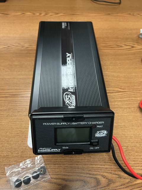

And I’m loving the new power supply from XS Power…held voltage steady at 14+ all day long.

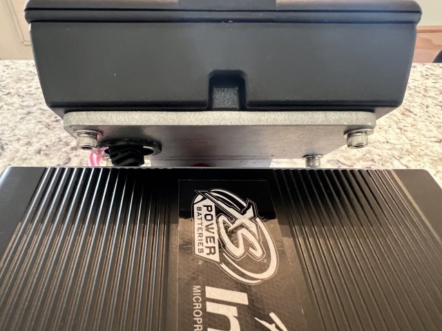

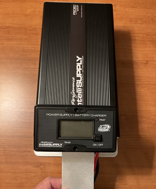

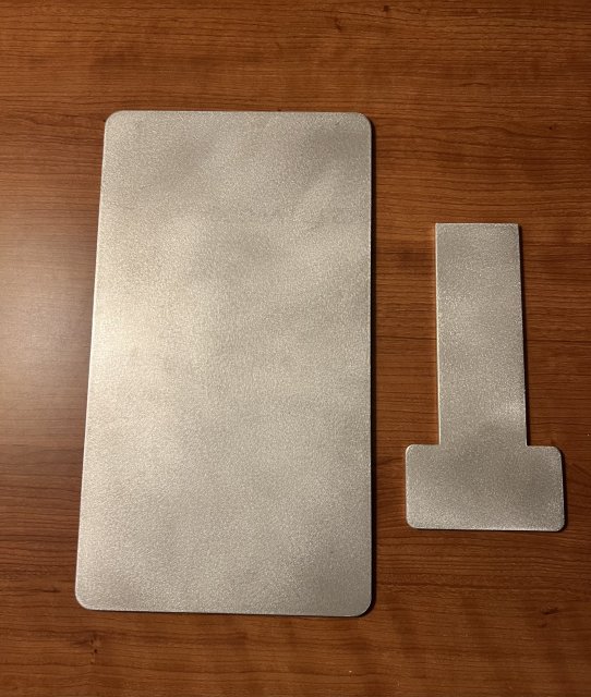

I had a buddy with a waterjet cut me out a base and display mounting bracket from 3/16” 6061 aluminum today. I’ll anneal and bend the bracket to mount it all up. It’ll sit on rubber feet also. Didn’t wanna just throw around a rather expensive power supply. D5F466FB-CB35-48DD-8C78-5409F187060F.jpeg EC1BFDCD-C417-4433-A630-DC529B7C841C.jpeg 2A1A6BD1-3865-48E8-B7F7-54B982414E58.jpeg

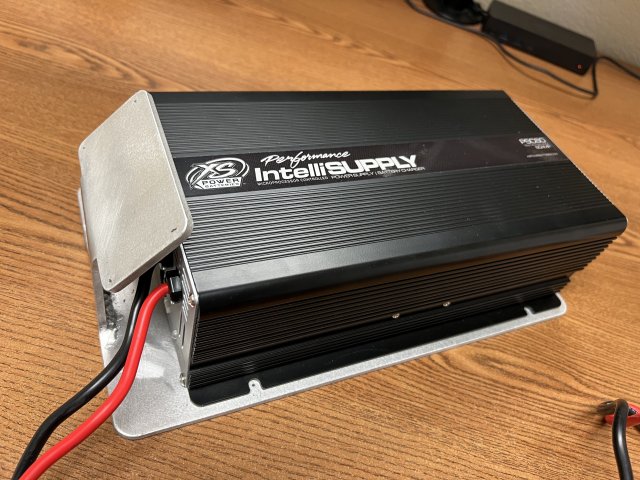

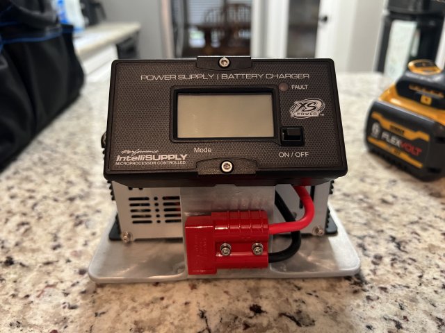

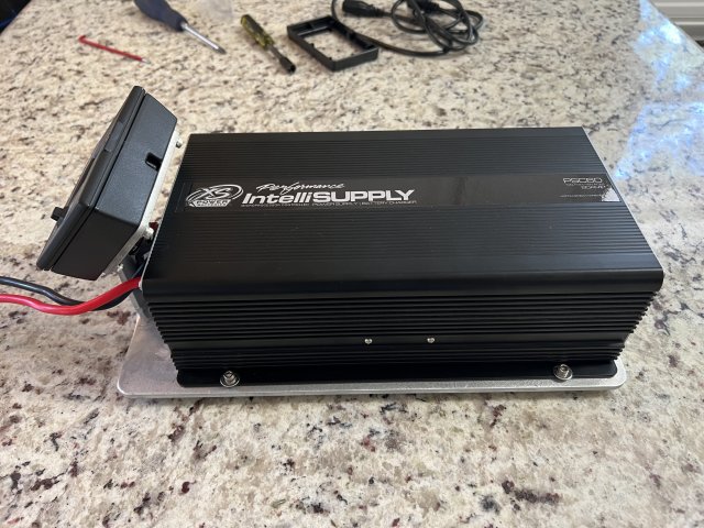

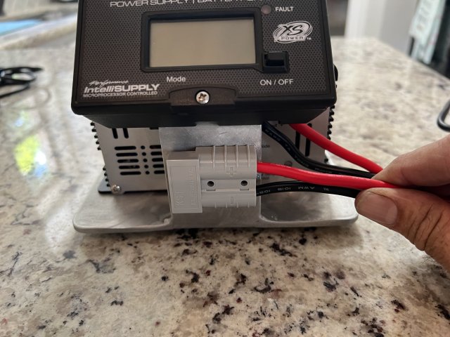

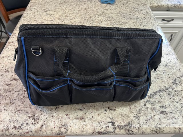

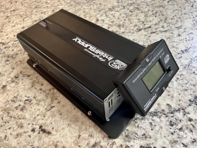

Everything test fit with stainless cap screws and female threaded rubber feet for the base. Once my bigger Anderson plugs and 4 gauge wiring get here I’ll shorten the wires up and mount a plug to the base as shown. And I had to get a carry bag for my extension cord and the wiring from the supply to the car.

slick that it fits in the tool bag.

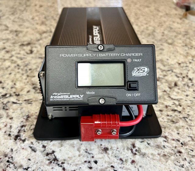

Finally got the Anderson plugs in and one hard mounted to the base like I wanted. Everything will be nice and compact with no loose wires hanging off of it. Painted the base and I’ll put it all back together tomorrow. 6F77D07E-36CD-46C2-AD80-836B00DA28E6.jpeg

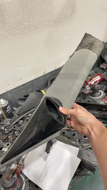

And done. Now to strip the front doors down next weekend and get the a-pillar mods completed. 2A72B5B6-F52A-49A7-874B-8A26EE10BC49.jpeg 4F2333E8-8A59-42ED-A1DD-05C0C4CA76D8.jpeg 7C849DCB-70E1-41BF-99C1-70505774ACC4.jpeg

Slow progress but should be final sanded today and then to upholstery tomorrow. CE0C6F0D-E987-43A8-801A-03CE6C9E6EF4.jpeg

The final shape. Upholstery material got hung in shipping but they’ll be in my hands by Friday for a weekend install. E8A57452-D4C6-4843-B711-DF615E05378A.jpeg

Is this the MTI prototype? (I believe that's who you stated was doing the work, if not I apologize)
4,994
5,973
Thread Starter #200
Yep. First set from them.
