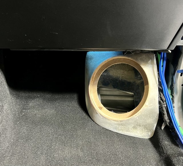

Thread Starter #241

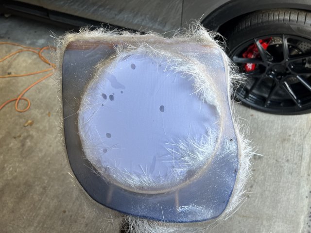

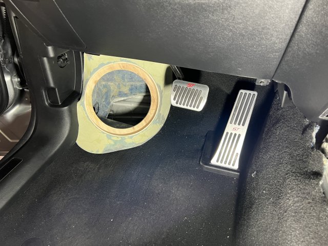

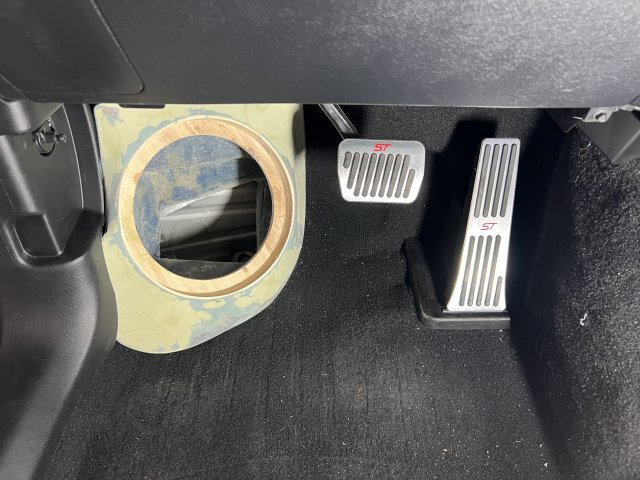

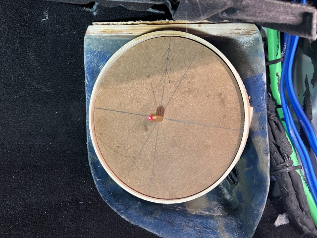

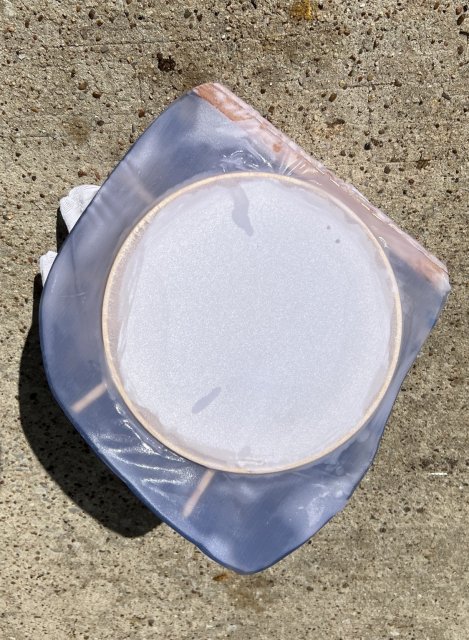

Today I got the holes cut, speaker rings aimed and mounted then the cloth pulled with resin and first layer of mat applied. 1 more layer outside and 2 inside tomorrow. 8D6C6BE2-BFFE-494E-871B-AFD2E7B5C734.jpeg A1ACDA35-95ED-425E-B257-FD87F5327C6B.jpeg 4410E94E-0306-423D-9C03-91689B1FC70E.jpeg 4C662D10-D9A4-49FD-A7A9-40C354160590.jpeg 0270FA75-FAF3-47C4-82EB-F77C2C7061BC.jpeg E5E339B3-20C4-453C-B9F8-2427A7D66263.jpeg

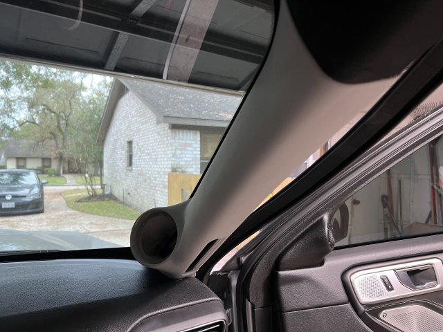

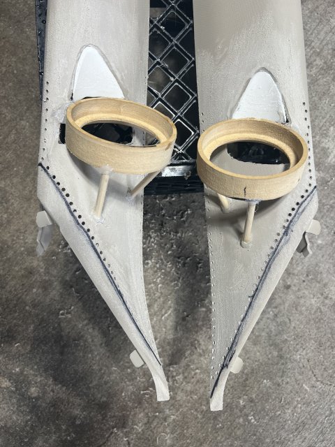

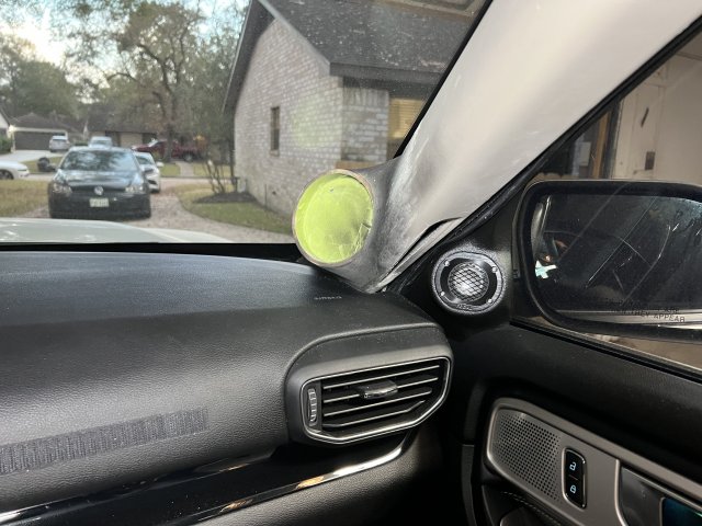

Thread Starter #242

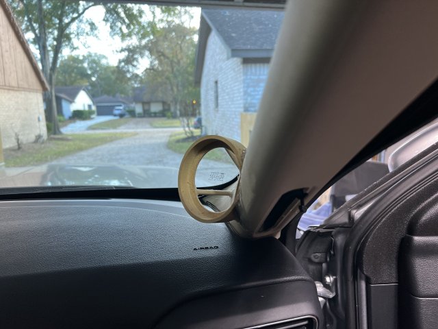

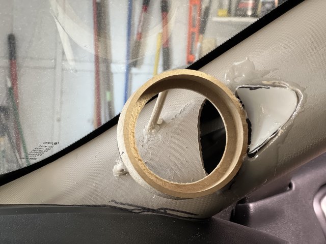

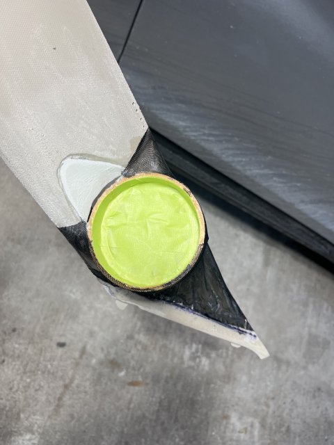

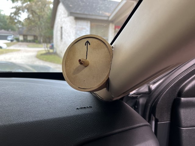

Lots of glass on the kick panel pods today and while that’s curing I started the new a-pillars. Aimed just behind the rear view mirror then attached the rings and made a plastic insert to blend in above the rings. That’s it for this week. 58D00672-7299-4818-9133-CA6B4EC389D9.jpeg 389A2EB6-D8F4-4600-B2CF-5B534FDD2C16.jpeg 4AB59FEA-CEDB-461A-B882-FB9AC2CF68B9.jpeg

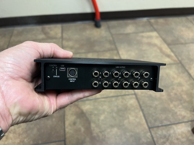

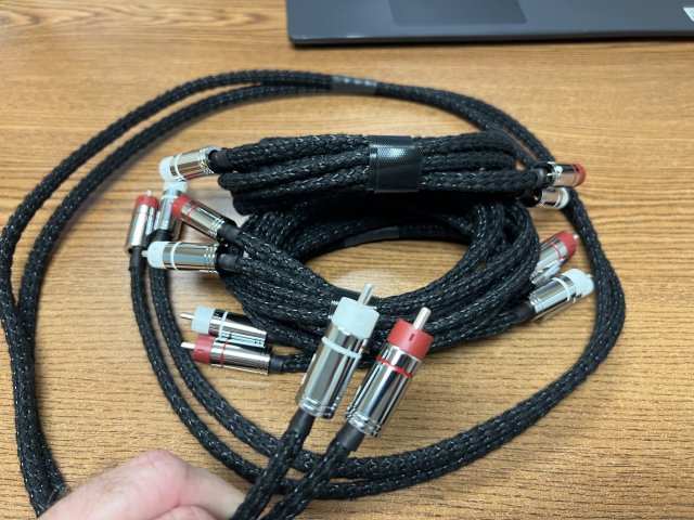

New RCA’s came in today. RSD Custom Cables silver core Ultras. 76565C77-2EB9-4706-B935-657DF55C9872.jpeg

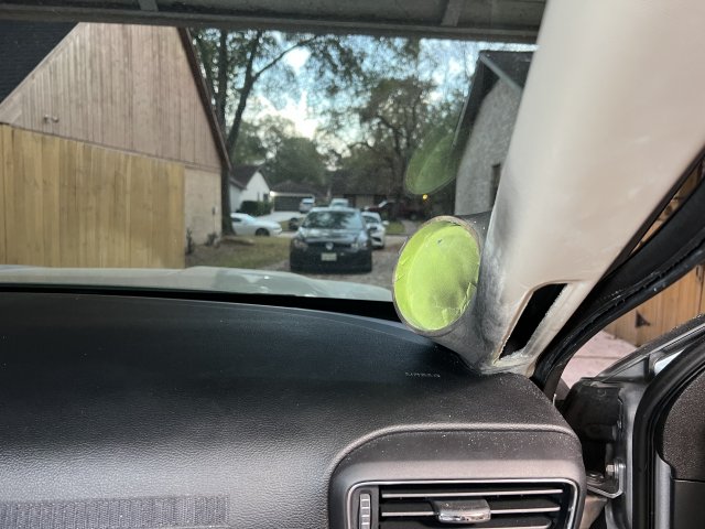

Thread Starter #244
Killed a few minutes pulling cloth and getting resin on the a-pillars. Glass tomorrow so I can start sanding and filler on these and the kick panels this weekend. 414B88FA-9F29-4C76-9049-8DA9A7465286.jpeg FA48EEAA-62DF-48AA-857E-6C080636C767.jpeg

Thread Starter #245
Final shape is starting to show up. 625FCA8A-8B26-458A-ADDC-CBF6851B52C2.jpeg

Thread Starter #247

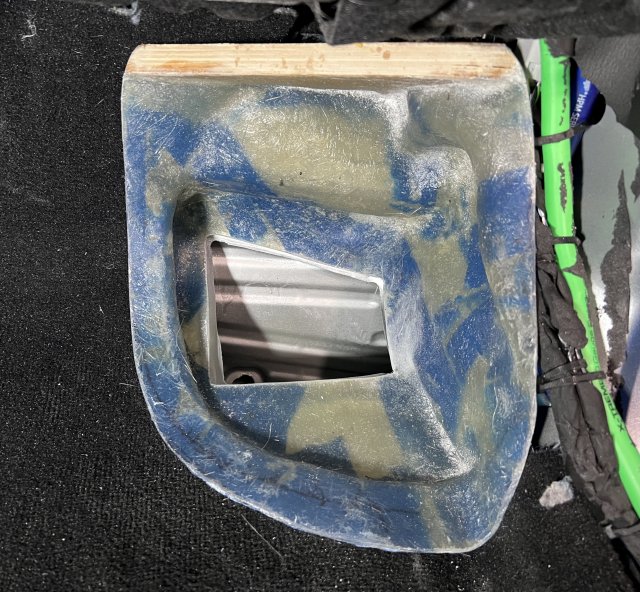

Outside is ready to wrap. Inside still needs lead shot milkshake and threaded inserts for the speakers…I’ll finish that this weekend. B8A27314-A6BB-4637-BAB9-D18F358212D3.jpeg DA547EA6-8EC5-4CEB-A00F-88E22338A859.jpeg E0D3B266-E29B-4C79-9115-E37461B06566.jpeg 83C88448-2D68-464C-95DD-4A84DA3929DF.jpeg

I didn’t take many pic of the process…because who cares about multiple layers of fiberglass and filler, right? lol
I am at this point though…all machine sanded. Hand sanding tomorrow to look for high/low spots, pinholes and do some final shaping. These will be covered in non-backed headliner material so they need to be pretty damn close to perfect.
I also need to cut the back behind the speaker out and milkshake the back. All in all…I’m getting pretty excited to see it all finished.

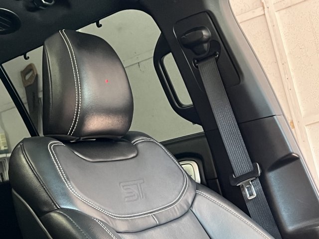

Final test fit before I paint them black so nothing shows through the upholstery and that’s were it’ll sit for a couple of weeks at least. I have a busy week at work then the wife and I are going to Mexico for a while. 71655298-8F31-4D28-858D-AB7C2B64DC6C.jpeg

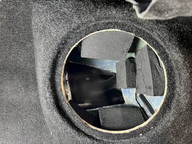

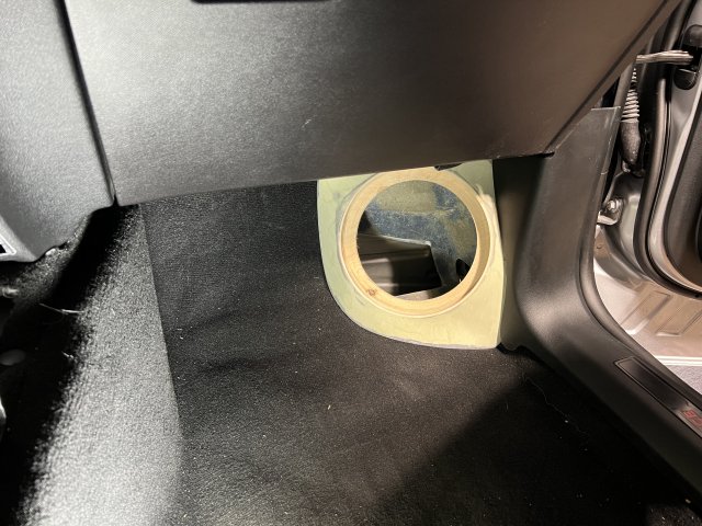

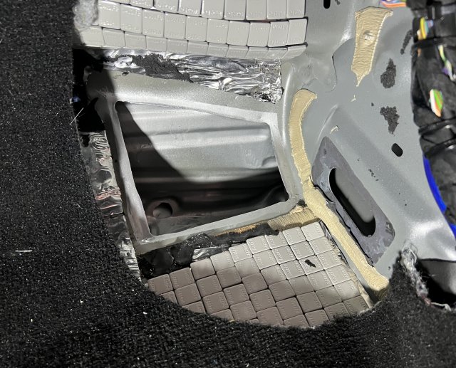

Powering through still being sick today….got the lead shot milkshake done and both pods carpeted along with the rivnuts in place. Tomorrows list:
Finish CLD inside floor.
CCF back side of pods.
Blackhole Tiles in pods and floor.
Run speaker wire.
Water shield in place.
Bolt pods in place.
Install speakers.
And that should wrap these up minus the grilles. I still couldn’t resist a look at what’s to come.
940EC2EA-9F82-43A8-9B48-462128C22006.jpeg BE720988-4D2F-4478-B88A-ACFEA185C848.jpeg F94E8753-0883-4E69-836E-BA6717430B97.jpeg

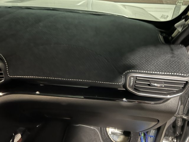

Ran by and grabbed my stuff from the upholstery shop. They sewed the border back on after I cut the mats to fit and matched the oem white stitching then I had them do the same stitching on my dash mat.
F4DA9A51-6F9C-4215-9B66-283AB9FEC96D.jpeg E0BFF026-2B73-4E11-B4D7-77A533BCC140.jpeg

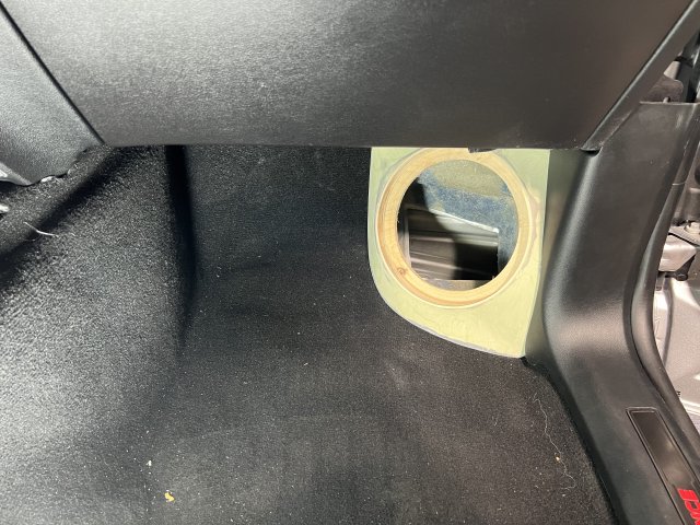

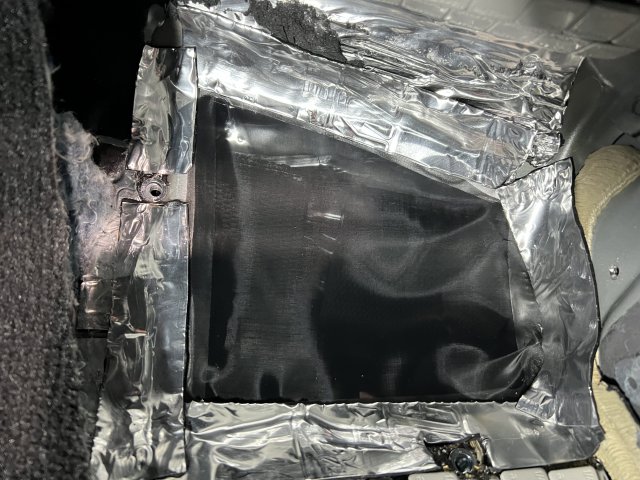

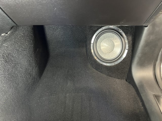

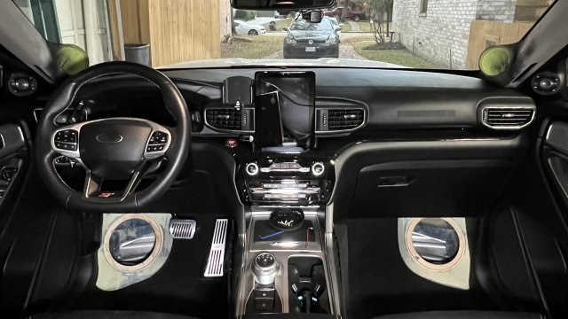

Thread Starter #258

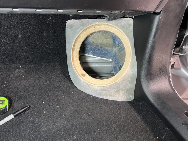

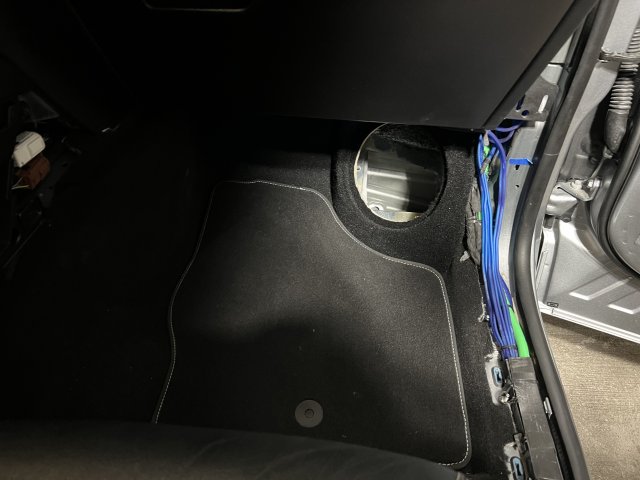

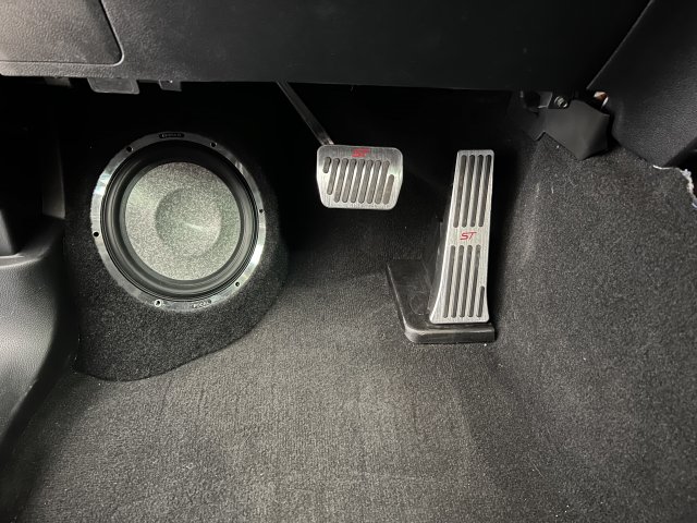

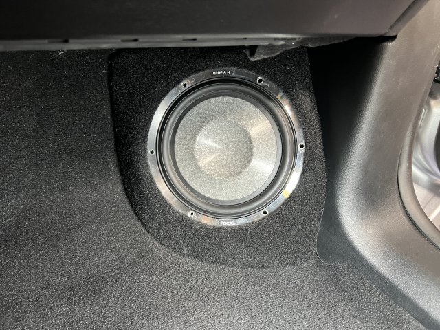

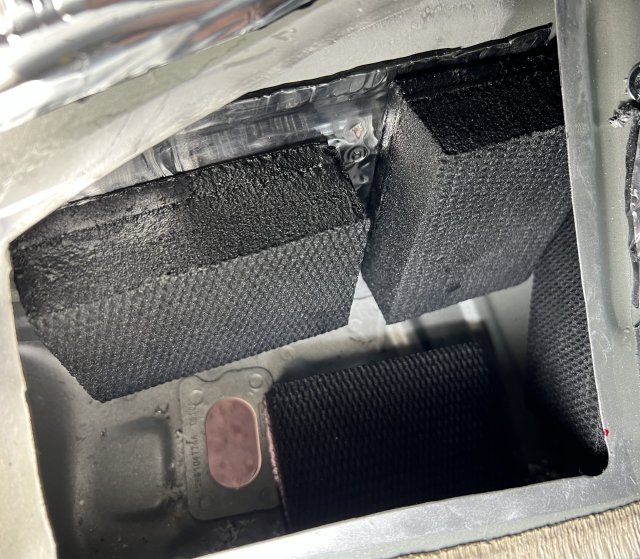

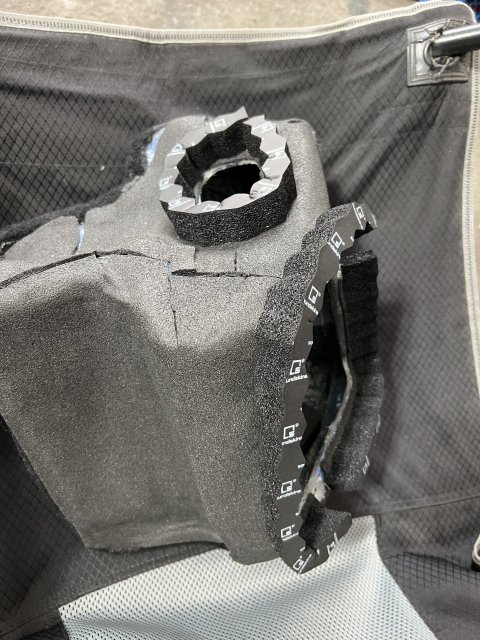

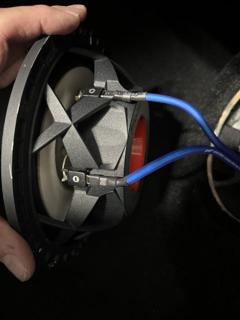

Almost done with the floors. I’ll get the grilles made in a week or so when I can get to a friends shop with a router table.
CLD and Blackhole Tiles inside the sub-floor.
Mo-flow Ventilation pre-filter material for a weathershield between the floors.
More Blackhole Tiles inside the pods.
Pods lined with 1/8” CCF and Soundskins speaker rings to make sure the vent holes are sealed to the floor.
Speaker connections nice and clean.
And the finished product minus the grilles. 50483535-F5D8-4E71-B220-42E775E2B94E.jpeg
