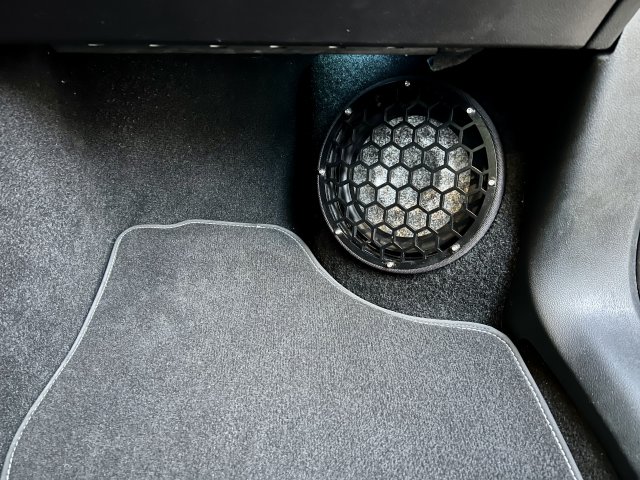

Thread Starter #275
So I did finish up those grilles. The plan was to inset them into wooden rings and cover the whole thing with grille cloth…but that turned into only wrapping the rings so I can still see the speaker cone and adding some cap screws to match the sub mounting in the back. F312602B-2C89-4DD3-A7F5-75EF5B204695.jpeg
Like things sometimes do…that got my brain spinning and it’s now evolved into this idea which went to the water jet place today. The new grilles will match the style of the Focal tweeter grilles and will be inset into a polished black acrylic ring. That will match the trim ring going on the midrange and also tie into the piano black dash trim. Then I had to match the screws to the bevel head titanium screws in the tweeters so $5.40 per screw later those will be delivered tomorrow. Basically my grille idea restarted from scratch.
23CD711F-BBCE-4648-930C-9FA8BB8874DC.jpeg E0E68A01-D4A7-4830-84BE-14349D9C7FDD.jpeg

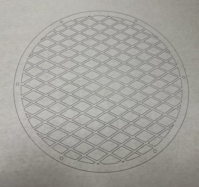

Thread Starter #279
Thought this was interesting. My new midbass grilles are cutting as I type. 8” OD, 1/8” thick 316L stainless steel. 618” of total cut with 332 pierces between the 2. Roughly 3 hours to cut on the water jet.
