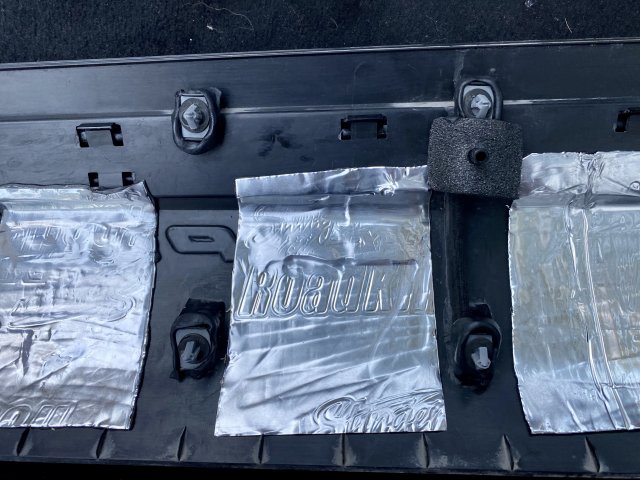

Thread Starter #83

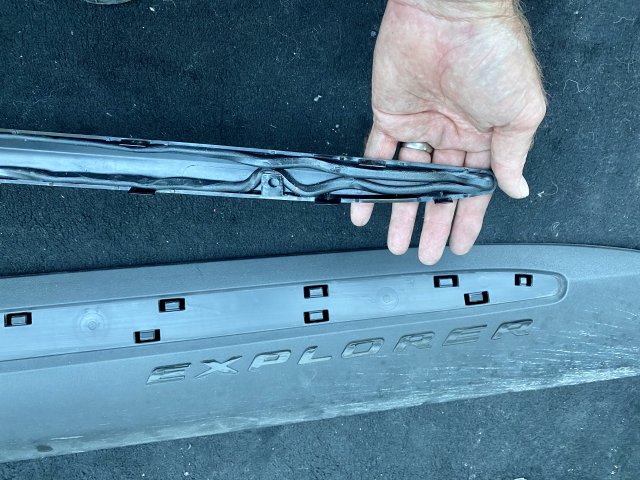

The 8’s exposed some serious rattles in the outer door cladding…that went away today with a combination of CCF, CLD, Tessa tape and butyl rope. AAECD2B4-ECFF-49EB-BB8C-CE7359BF78A3.jpeg 033129C6-47DC-4AFB-A986-6F73B26B3EF0.jpeg 18395A4B-3740-446E-B30A-1552EAA77731.jpeg

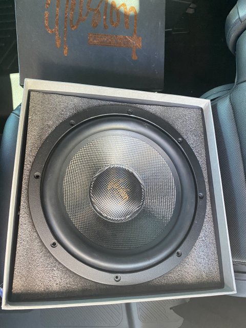

Thread Starter #88

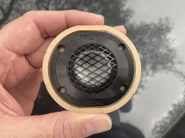

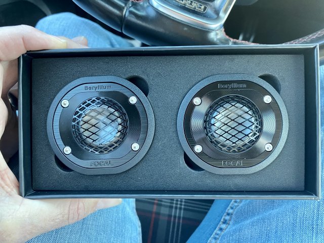

Forgot about these I picked up last week.
Focal Utopia TBM tweeters…the final big piece to the new puzzle. These will be glassed into the sail panels.

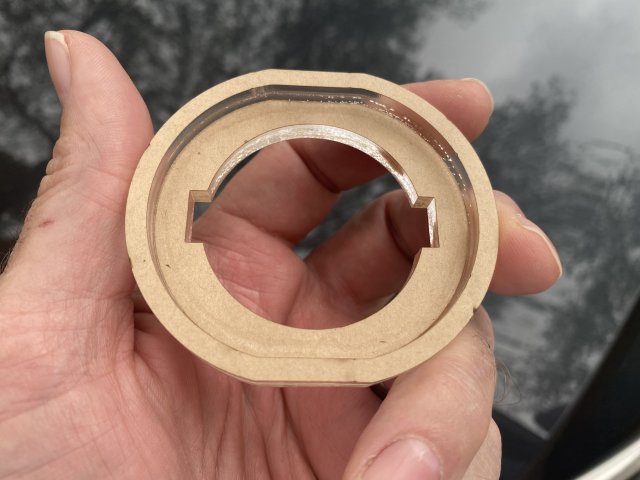

Thread Starter #100
I was drawing a blank when I comes to mounting the tweeters in the sail panels…they’re tiny and these tweeters aren’t so I ran by a friends shop and he had this idea…so I went by another friends shop and we played with his laser for a little bit. 3589084B-066E-4A67-B058-C0A7E5511EEC.jpeg 18340DB7-847F-4B2C-A6AA-483F208923DA.jpeg
