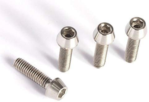

For things I put together with exposed hardware I always use taper head titanium…so I had to order bolts for the subs and tweeters. I’ll have to turn the heads myself for the sub bolts…I could only find parallel head.

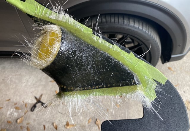

3 layers of chop mat…so much fun.

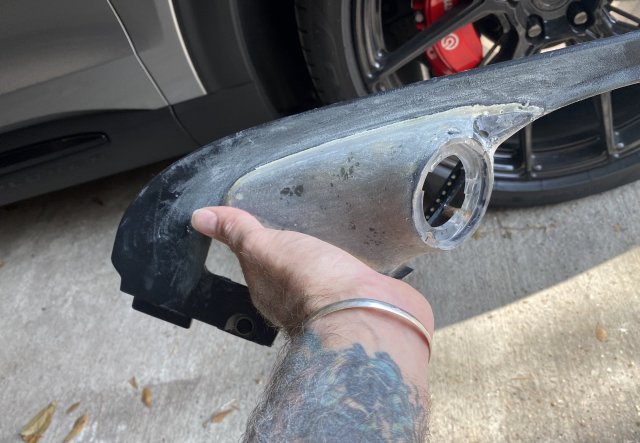

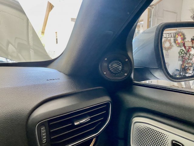

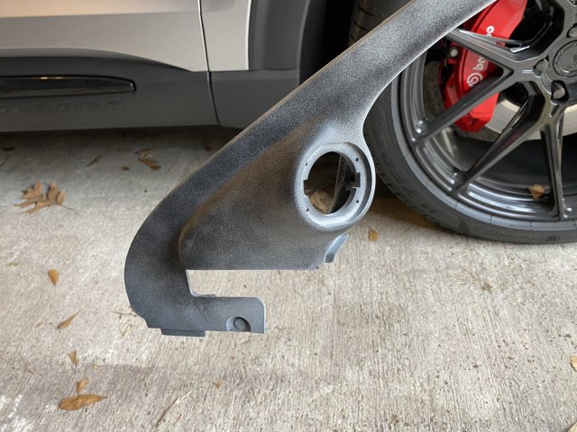

Guide coat is on…final sanding this week then texture coat and paint. Using all SEM products.

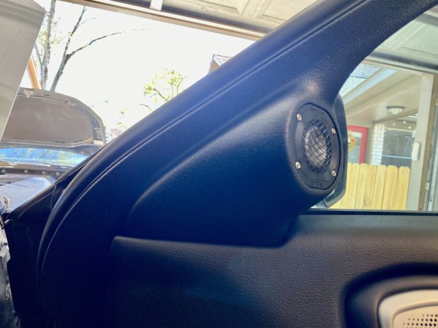

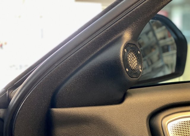

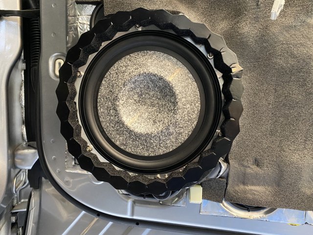

Buttoning up the doors today. Now for break in and tuning FF132A8D-A5A8-426E-B757-B77535246980.jpeg 7E9BA944-80A5-4324-932D-0E565BF0D1E5.jpeg C0495C77-D90F-4DDA-881F-DC8760FD6FCD.jpeg 96F13812-D678-4248-B02D-3537DB286BFE.jpeg
1,854
1,332
Man those mounts look FANTASTIC! Looks like it could be stock. Nice work! I'm glad my sub box will be hidden behind a panel as my finish skills are not up to par.
156
87
Salem, OR, USA
I really need to drive to Texas and learn from the expert!
1,502
What did you use to get that mild "pebbled" look?
4,994
5,973
Thread Starter #134
SEM texture spray. Videos make it look easy…I disagree. lol
I had to retexture the whole piece to get it to match. Even holding the can 24” away it was still heavy.

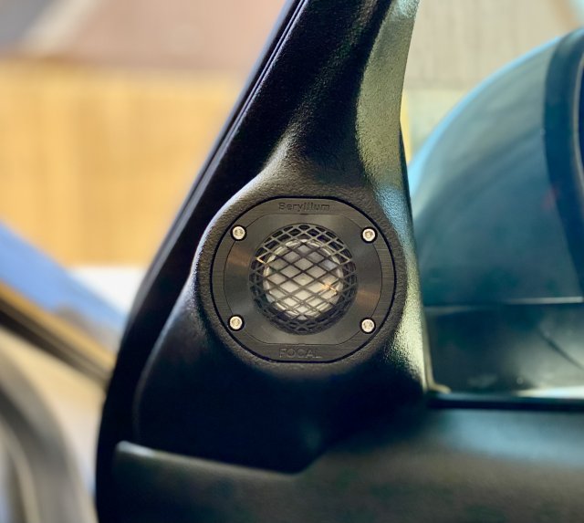

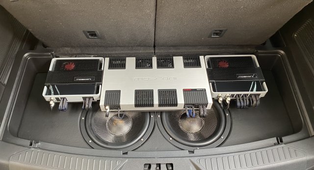

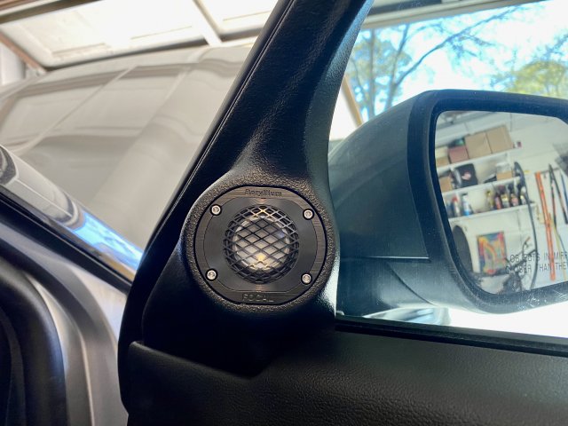

1,854
1,332
You've got mad skills there! I'm embarrassed when I look at my sub enclosure :)

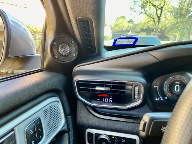

Thread Starter #140
