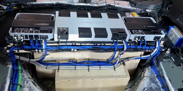

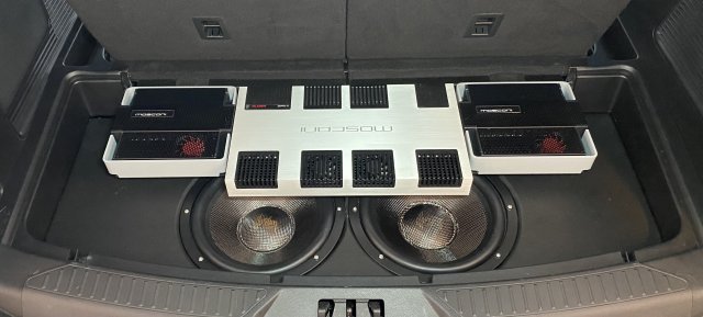

I thought I could live with wires showing but I couldn’t. Pulled everything out, disassembled the pair of Pro amps and flipped their emblems then gently heated up and pulled the Zero 3 sticker off to flip that too. I’m having an acrylic emblem made to mimic the style on the Pros to cover the carved in letters on the Z3.
This is sooo much better.

The clearance on the RCA ends is literally zero with them flipped…but I made them fit. lol
I didn’t do it originally because I didn’t have enough room. The amps were mounted on a 1/2” piece of birch. After I had the 3/16” aluminum plate cut it gave me just barely enough room to pull it off.

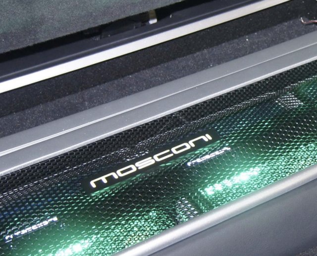

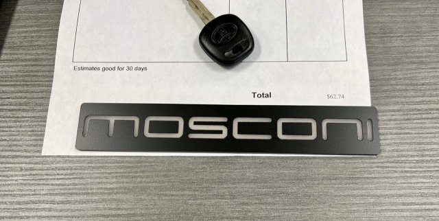

Like I said…I’m having one made from acryllic that will be similar to the emblems on the Pros. The guy that made this one is making it now. 6F909DA3-3FB7-4C74-AB27-D4AB3714788A.jpeg

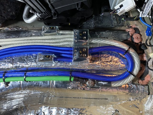

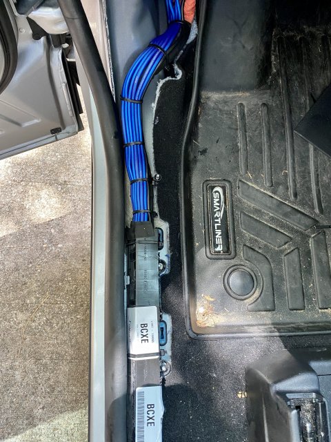

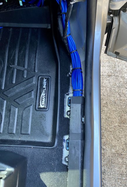

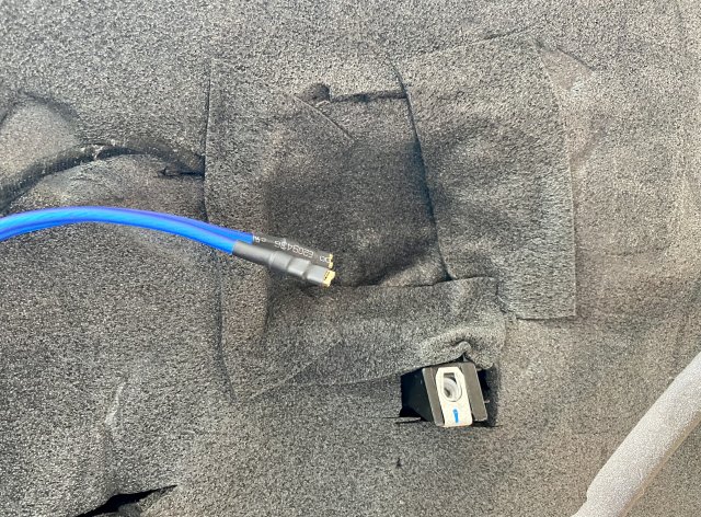

If everything showing looks pretty but the back side looks like hell…it’s still a fail. Finally finished up the cable clean up today…plus some old pics so it’s all in one spot.
E42BD11B-C8D5-4805-9D52-1F7176AD6C87.jpeg ED6FAA53-4FA9-4D9C-A7D1-098D7BF51EAE.jpeg 22F97789-CE82-4190-A83F-178109F653FC.jpeg 87D75904-1129-4F39-9F2E-36E15731A4C3.jpeg D3DC6BC6-DB73-4F8C-A75B-E66E473BCC24.jpeg 6111761E-6C72-4F92-A43B-D8DA40D1F20B.jpeg D1CBDF42-FC4D-4145-8577-6D8D00EB7E47.jpeg A8BB3F00-9357-42E2-980F-0B868945EE14.jpeg

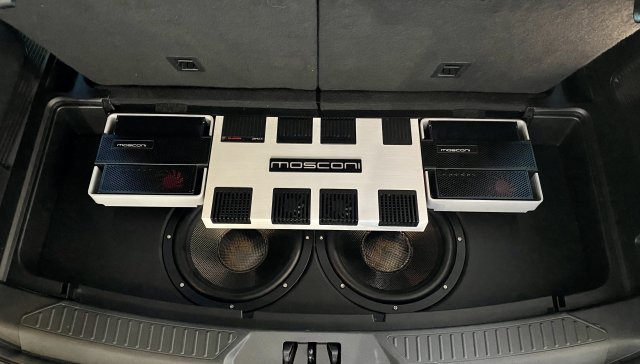

Got the custom emblem taped on so now everything faces the right way. Building the new false floor panel now and that’ll mostly finish this build. I’m pulling the interior panels out next weekend to add a whole layer of 3M SM400L Thinsulate for some additional noise control while driving. E00B2097-1FFC-42B8-AF38-BCA2F31AE08A.jpeg

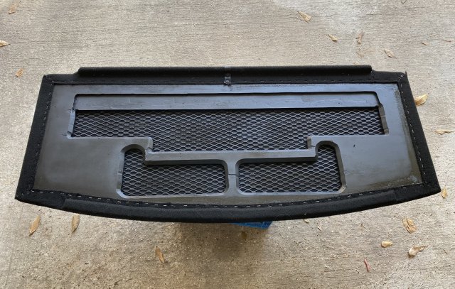

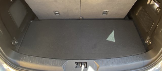

False floor done. It’s rough underneath…that’s what happens when I get in a rush. Nobody will ever see it anyway. It’s vented all the way across the amps where the fans are and directly above the subs. E6A2193F-8D0C-4484-BB8D-01ABA5E94197.jpeg 7B352C6A-1E5E-42CA-9056-83E377E9EBB7.jpeg

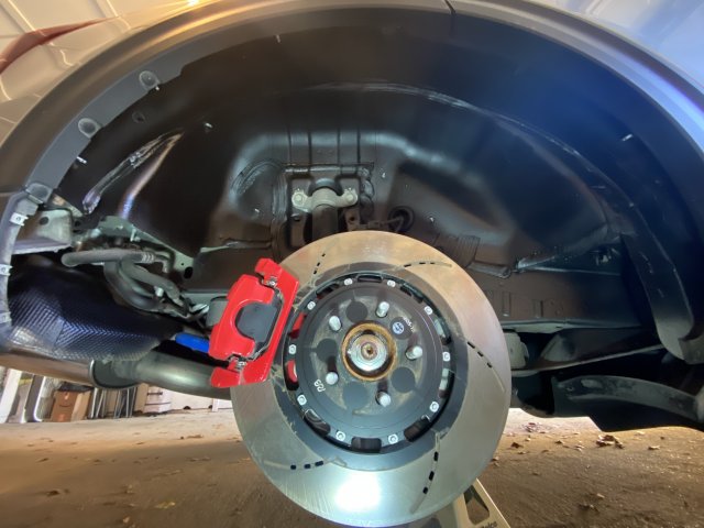

Plowing through shit today….rubberized undercoat for more sound deadening in the rear wheel wells. 9A908199-522B-4923-86D0-2B0567F0BAAC.jpeg

Wonder how much weight in copper alone you have added. I was thinking about the wheel wells as well. Car is really "tinny" compared to my last 4 vehicles. Trying to rid that any way I can.
