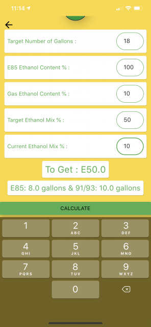

I just downloaded the mixture app. Here is a screenshot of it. How do you get the “Gas Ethanol Content” number? Does it say on the pump?

In VA it is 10...for most Pumps. Most of the time it will say on the Pump, but sometimes it will be a range(5-15). You can test it, but it has always been 10 at the 2 Stations I use.

I wait until I get to a quarter of a tank before I refill

Cool, thanks. So 1/4 of a tank means you still have 18 gallons until full correct? So if I wanted to minimize the weight for the track, I would just set that number to a lesser amount I guess.

Correct!

My guy at the dealership said wait until it gets to 1/4 of a tank then plug in the numbers and it should give you the mix. In my case it’s always 8 E85 and 10-91/93

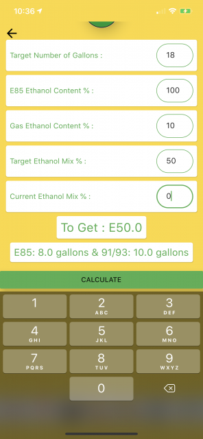

My Chevron says minimum E75. So I assume it’s E85. I also put it at E75 and it says add one additional gallon on the app.

What app are you using and did you actually test the E85?
Most Gas(87/93) contains a percentage of Ethanol. In VA that is 10% or E10. I also test my stations E85/Flexfuel every couple of fill-ups. It is currently running at actually E85, but I have seen it as low as E70.
In the mixing app you need to factor the 93 Ethanol content in.

No I have not checked it. I’m using the E85 App it shows you where all the locations are in your area. You are correct. My Chevron has minimum of 10% but the so has room to plug that in. My Chevron says minimum is 75. So I’m just talking their word for it.

This is the app I use and it does a good job. If you are using a ZFG E50 tune, it will handle E40-E60 with no issues.
If you can test, I highly recommend it. My Stations said it can be as low as E51, but it has never been close.
