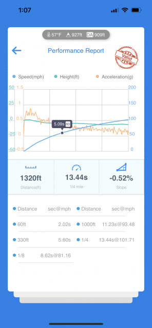

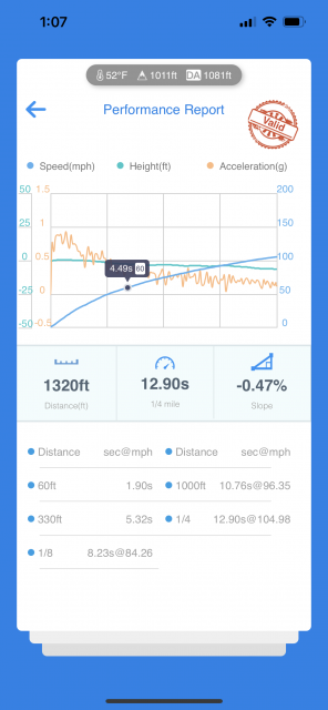

wish someone would post some Dragy times with this Ford tune really curious the difference.
I’ll admit I wasn’t expecting too much. After the FP calibration was loaded I took it easy to for 3 or 4 days to give the ECM time to dial in OAR and transmission adaptive learning to occur. First WOT pull surprised me, it pulled harder than I expected, shifted crisper, and smoother throughout the rev range. See Dragy results, the FP calibration shaved 1/2 second off 0-60 and 1/4 mile, trap speeds up 3 mph. Both runs were with 93 and whipple intercooler. OAR on stock pulls was 100% and about 95% with the FP calibration.
