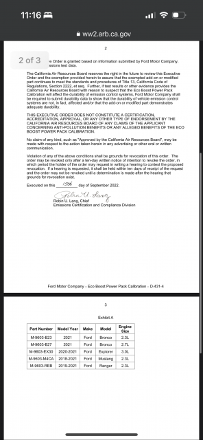

Here is the executive order from California. To me it just acknowledges that the tune does not affect any emissions on the car. It also to me seems like California just hasn’t updated it to include the 2022 year of vehicles. No 2022 ford is included in this order of exemption.

You're correct, I'm a former CA Smog Tech/BAR Trainer and a factory tune would not be identified during a normal emmissions inspection.

this is a curious question though. im thinking that the Ford Performance Tune would be found during inspection since all 2000 and newer cars use OBDII and visual inspections not the sniff test anymore. Thus the reason why you cant get this tune in CA as of yet. the reality of it though is new cars in CA dont require a smog inspection for the first 7 years of its life so you may be fine with the tune as by that time it will have passed CARB and be allowed in CA since its a "Factory" tune.
Another reality is, these tunes as well as ZFG can be removed at any time so when it comes down to smogging the car all you need to do is revert back to the stock tune, smog it and put it back on barring you have any other non-CARB legal mods.

That's correct, most likely by the time they get to the first emissions test the 2022 should be approved anyway. The OBDII test checks for MIL status (on or off), DTC's, and Mode $06 monitor status, the BAR OIS doesn't check for software versions yet as far as I know. (I let my license lapse a few years ago so I could be wrong lol!). That's why I say most smog techs would most likely not catch the Ford Tune, I don't know if any of the aftermarket tunes still display correct monitor status or not since I haven't looked at them yet. But yes, if someone was concerned they can revert to stock for the inspection like you said. I remember failing a Honda years ago because all of the monitors had passed...even on systems not equipped on the vehicle. I never saw the vehicle again so I don't know what happened.
