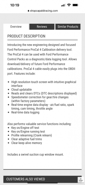

Anyone have any info on the capabilities of the ProCal 4? Is it a repackaged SCT or other device. Can it be used for monitoring or just to deliver the tune?

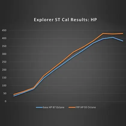

I think the most underappreciated part of my ZFG tune is how smooth the transmission is, especially compared to stock. Ford did an awful job programming the transmission, and I find it hard to believe they smoothed anything out in this new "tune". +30HP for $700, no thanks.
Also, did anyone notice the dyno graph compares "Base tune on 87 oct" vs "Performance tune on 93 oct"? Yeah, double no thanks.
A Bronco Raptor owner said the transmission shifted better and smoother vs the ST, both have the same transmission. Im sure Ford tweaked some stuff to make it similar to the Brapter.
Far as the graph, I mean we know damn well they dont make 400hp on 87 octane to begin with.
354
I can tell you right now that "graph" was created by someone plotting numbers in Excel and was not from a real dyno. 400hp rating is crank HP on a dyno test stand.
Oh im fully aware and agree. Just wanting to show a nice graph lol But still to the point, usually Ford claims are underrated on boost cars, was the same with the performance tunes on the Mustang Ecoboost and GT. Nobody had any major complaints with those and enjoyed the added power with "warranty", It will be the same case here.
However, I believe one of them had a slight high A/F ratio at least from what I recall.

... Also, did anyone notice the dyno graph compares "Base tune on 87 oct" vs "Performance tune on 93 oct"? Yeah, double no thanks.
Yeah, I pointed that out two days ago in post #119.;)
The base hp on that graph is listed at 400 hp with 87 octane, that's the problem. Because Ford advertises they got the 400 hp dyno result on Premium fuel.
Going by the graph then, you get 400 hp with 87 octane and probaly 415-420 hp with premium, so the tune is only worth 10-15 hp. Very confusing ...
Based on the information that was provided you are better off just filling your tank with 93 octane and saving the $700.
Yup, that's exactly what it seems like to me. I mean yes, there is some gain in hp/torque. But not a whole lot, right?
