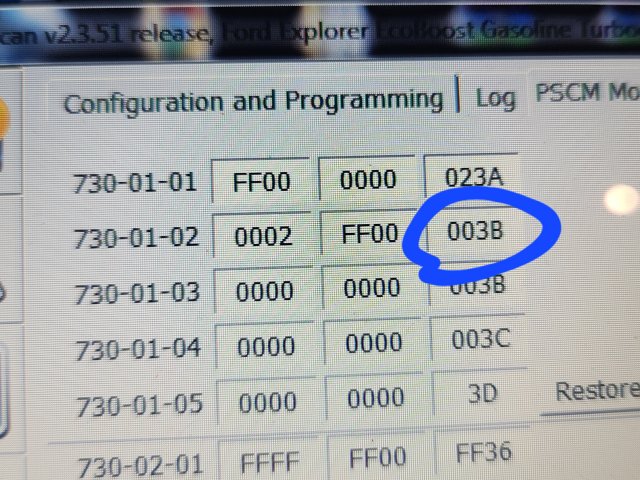

I did the change posted above in the PSCM to disable Auto Stop Start on a brand new 2023 and it's been disabled ever since. I've combed numerous vin's from 2022 XLTs with the 2.3 eco, which where the only ones that came in 2022 with the option to not have ASS installed. That option matches what's in those PSCMs so it's fair to say it's going to work permanently.
Basically, one of the features of the ASS is that it won't engage if it detects that there's a steering event happening, like you're at a traffic light and you slightly turn the wheel, the engine will turn back on. So if the PSCM option is turned off, it just doesn't send a signal to the PCM anymore, so it's default option is to just keep the engine on. That's it.

I'm just speculating here...I don't know the full logic or circuit behind how this change in Forscan works to prevent auto stop start. I think the PSCM change in Forscan is basically telling the car that some kind of steering event is happening, which will require the power steering pump to stay active, which will prevent ASS from turning on.

I just did it on my 2020. I'll let you know soon if it worked...
Can you post the exact values you have changed?
before and after values in the module.
I tried and did not work
237
95
Jessup, MD, USA
#60
Pretty sure it was this that did the trick:
PSCM 730-01-02 xxxx xxxx **--
**: 00=Auto Start/Stop Disabled 01=Auto Start/Stop Enabled, Angle Inhibit Enabled 02=Auto Start/Stop Enabled, Angle Inhibit Disabled
I think i tried everything else prior to no avail too. Not sure if the combination of everything is what made it work (I can't remember what the other parameters were).
