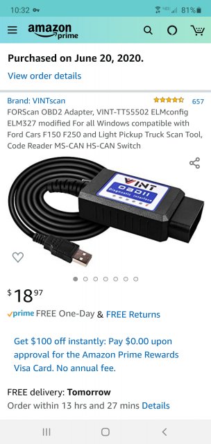

I got this one and it worked flawlessly for my updates, no need to spend 50 bucks.
