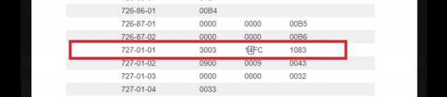

Turn off fake engine noise in Forscan.....It's under ASM....change the 4 to 0
Confirming that this worked. My cabin is eerily silent until I get my exhaust work done next week.

That's a typo. It's actually ACM. And set the number to 9 instead of 0, because 0 will disable your center dash speaker.
i saw a DTC related to speaker and i'm betting this will be fixed by changing the 0 to a 9 as you suggested. Gunna try it tn
