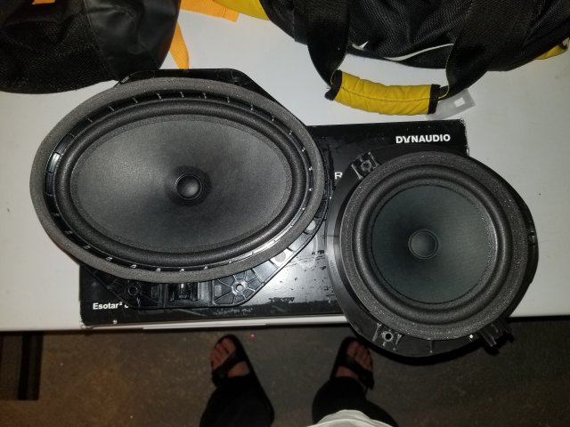

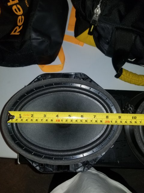

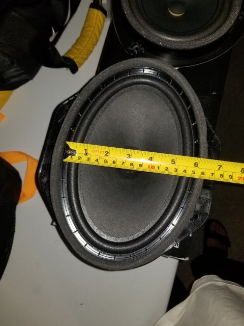

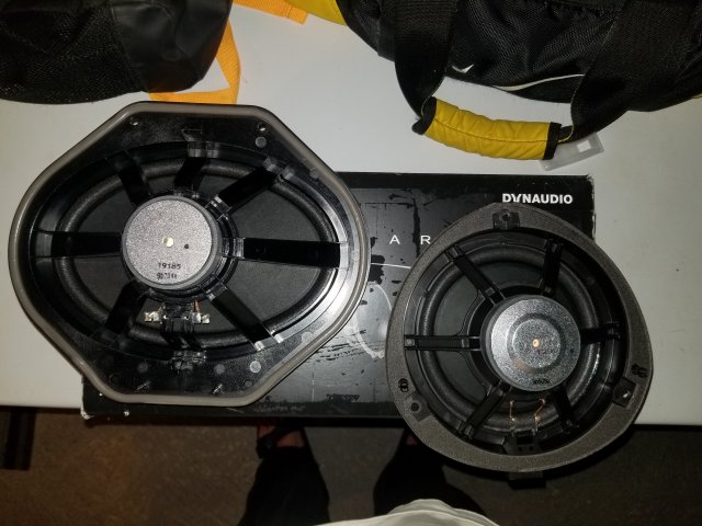

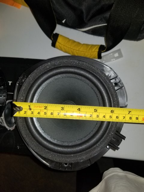

Just in case anybody was wondering the size & what the speakers looked like. Here you.go.My installer got a pair of the dynaudio mw172 which is an 8 inch woofer in the fronts no problem with the esostar 650 in the rears.
