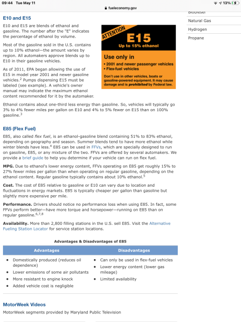

I get it - tons of ethanol. Its not a true 93 octane gasoline fuel because it has so much ethanol and although you FF engine may like it, you are using more of it per mile therefore its not cheaper. We need the SAE document to determine the standards that Ford uses but I'm not spending $85 for it! 3F9DF534-07A3-47E7-88B3-92CCC922C3A4.png

I gave you all the answers in your other thread. I have the document. I am well versed on the chemistry. Already answered.

If you have the document, print the bit about the fuel? Your answer was not definitive.
