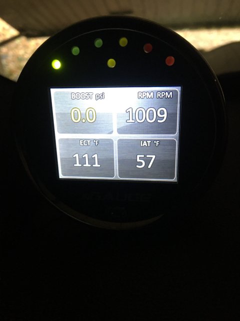

@Kruppa No noticeable changes in performance for me on the low end, but the boost seems to kick in quicker. I have an NGauge tuner installed, which displays boost and I’ve programmed the LEDs to light up at boost intervals, and they light up a little quicker it seems. No data to support that yet, though.

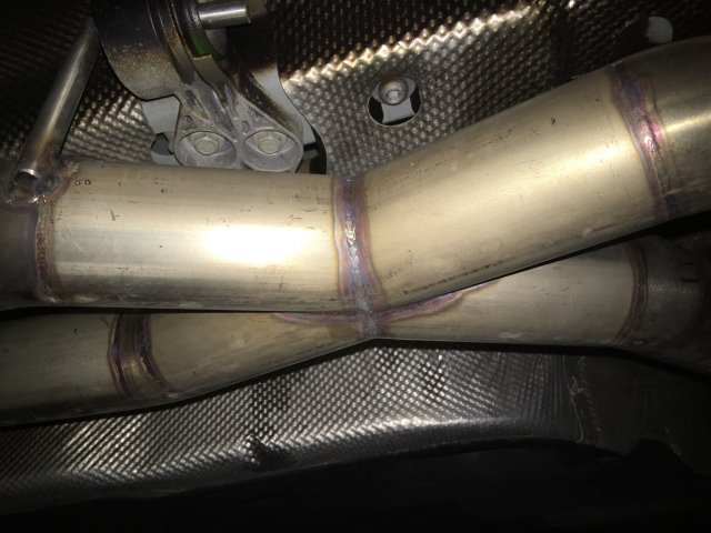

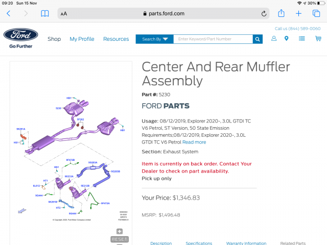

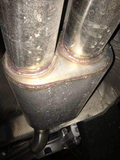

@Kevin 1456 I’ve attached pics, but I can also do a better job explaining it. You can see in the diagram the stock configuration. My setup eliminated the resonator in the middle and replaces it with an x pipe. The single in, dual out muffler is also called a center/dual by most manufacturers (Magnaflow, Borla, etc), which means there’s one pipe going in, and two exits. The stock ST mufflers are also Center/duals, but much heavier and more restrictive.

i was confused because my ST has dual input and output on the stock muffler under the car. must be a different system for the EU market.
The stock mufflers on the ST have a single input to each, with dual tips. They all come that way.

in his OEM picture it shows a Y pipe feeding the first muffler, our ST has two inputs into the first muffler.
Ahh, you're referring to the resonator. Yeah, that is strange, definitely are dual input, dual output on that.

I figured you were referring to the resonator, because they’re dual in dual out. As I said, mine was replaced by an x pipe.
