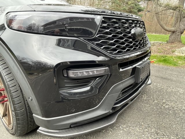

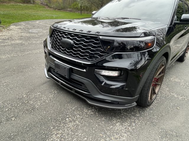

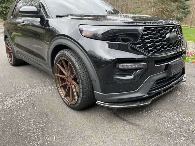

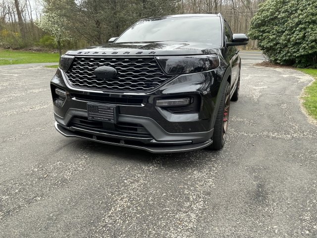

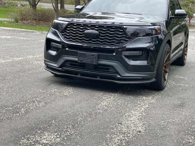

Throwing the headlight Lamin X on a waido front splitter today - pictures to follow shortly

And waido front spitter* I get all excited and forget how to type lol…

Thread Starter #46
Look’s nasty…

Blacked out looks great! Fun watching this come together...nice work.

Thread Starter #48
Thanks!! Much appreciated, still got some work to do, absolutely love the 20-24 explorer ST. Ford did a great job

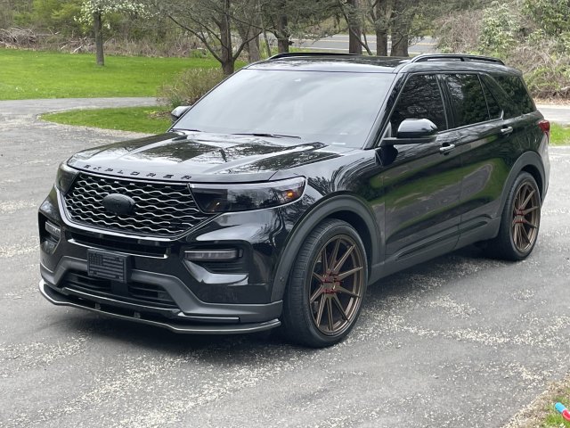

What did you use to tint the headlights, and is the output reduced by much?tyia Edit read you used lamin-x is that gunsmoke or tint? I really like the shade that its at

both are gunsmoke - yes - output is reduced a decent amount -

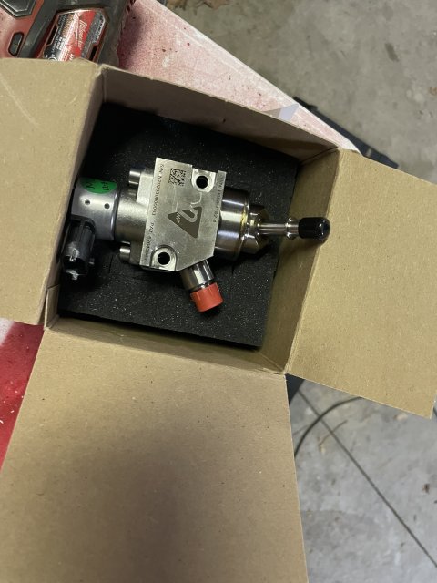

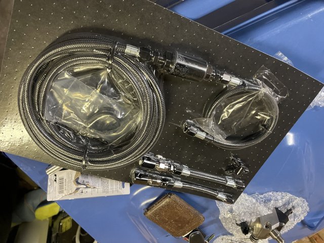

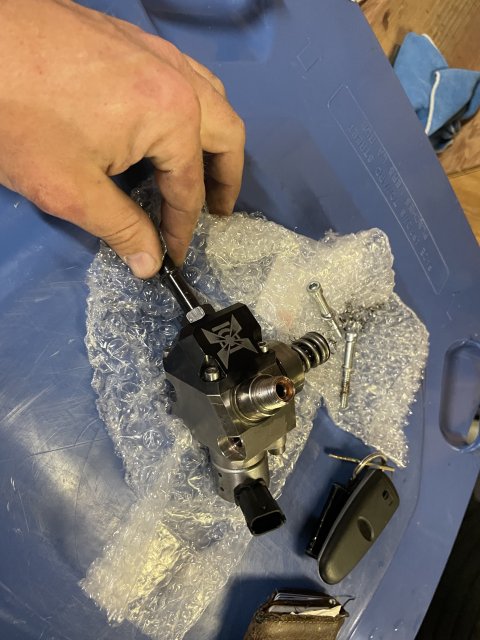

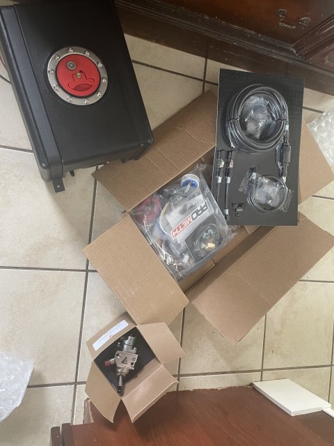

Got the meth kit and upgraded my fuel pump to the nostrum fuel pump..
mid anyone’s interested I’ll be selling my XDI Evo fuel pump - 650$ I’ll post it in the for sale forums…

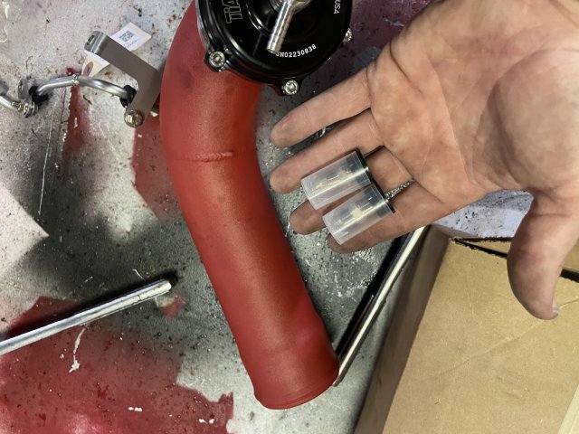

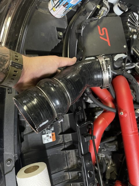

Ok… final stages of my build… gonna replace that rubber intake inlet with something that doesn’t collapse under pressure… then gotta tap in my 2 jets/nozzles for for the meth kit and getting the nostrum hpfp in (which I need desperately running the stage 3 injectors .. I made 637whp with Evo fuel pump which is about 20%less flow than the nostrum I’m swapping in.. with the nostrum pump and meth (80/20 meth/water) I have ZERO doubt I’ll be making 700whp on e60… have the vertical arms /subframe bushings to install as well… my next posts will be a video of the dyno pull with no meth and then with meth.. fun fact , I have a buddy with a 2021 m5 competition. We ran 4 times - 2 were 0-130, I won both by almost a full car. 30-130 won by 3/4 of car and 60-130 won by 1/4 car.. which tells me I’m consistently in the mid 10.5-10.8s… this thing is a MONSTER.. can not wait to get the trans built and improve shift times….
