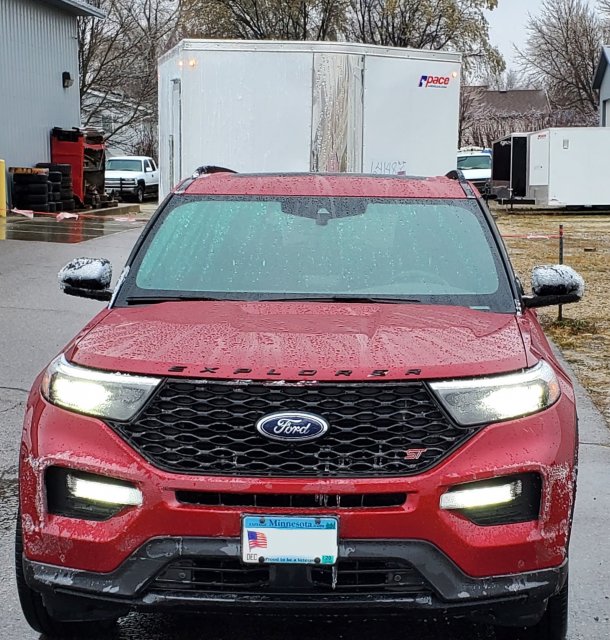

RE: Towing with H&R Springs, Steeda Sway bar, and BORA 1.25" Spacers all around. I've pulled my Can-Am Spyder in a 7h x 7w x 12l v-nosed Pace American trailer with no ill effects (well, fuel mileage took a hit). STwTrailerFrnt.jpg
