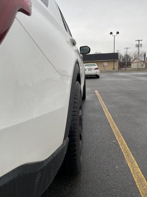

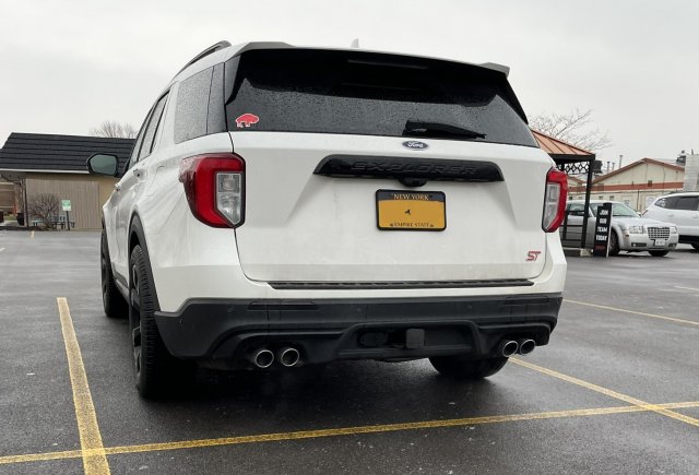

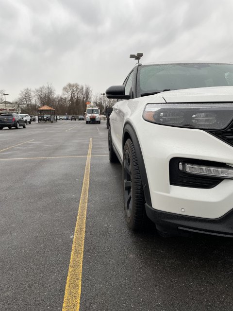

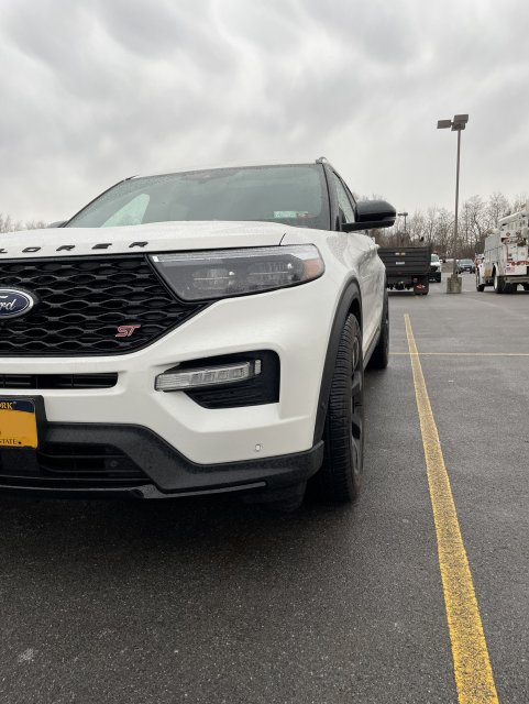

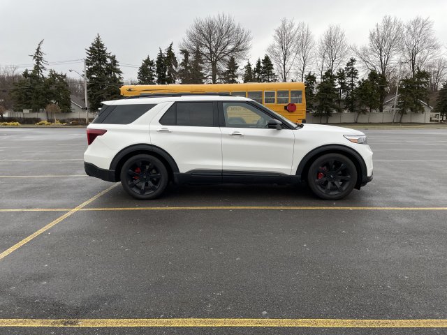

1.25" front, 1.5" rear. Stock 21" wheels, Steeda springs and sway bar. By handling improvement, I am talking the spacers alone.
Could you post a full view, maybe front back and side of yours with this combo? Thx!
Also I see that Steeda has spacers. Anyone have experience with them? BORA or STEEDA spacers?
