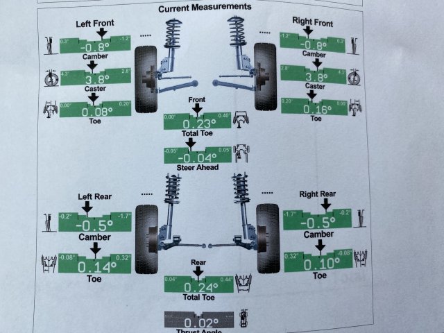

Can you ask them what they did on the rear please?
I went back through it today and can’t find an adjustment point. The 2019 SPC bolts are too big also so that’s a no go.
I was told they didn’t do anything special . Just followed normal protocol.

So I guess I just have a weird truck. We put it back on the rack today, loosened the inboard UCA bolt and I pulled on it with a damn 48” pry bar. It was still at -2. So we got medieval on it with a die grinder. Extended the slots about 1/4” and now we’re here.
Not the first time in my life I had an oddball issue. DBD4D9DC-1CFE-40E5-A072-A52B6075072A.jpeg
Not the first time in my life I had an oddball issue. View attachment 1257
I’m glad you won’t be eating tires now.
