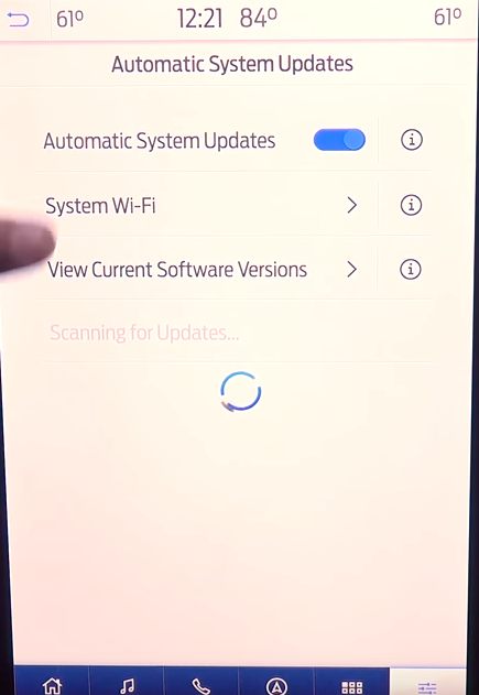

Has anyone downloaded any system updates over wifi yet?

I connected mine to my home WiFi and the update symbol just goes round and round and round but nothing happens
That's exactly what mine is doing. I let it sit there for almost 30 minutes and nothing happens.

My previous vehicle, a 2017 Explorer Sport had the same Sync 3 update feature via WiFi. But in the 3 years I had it, I wasn't ever able to perform an update this way. It just kept on spinning and timed out. I even tried it on multiple WiFi networks. It never worked! (I work in the Tech Marketing Space and am experienced with WiFi)
So what I had to do for Sync updates was to download the latest update file via the Ford Owners site to a USB drive, and then walk it out to the vehicle perform the update directly to Sync. This did work.

Thank you for this post everyone. I've been trying to do this all week. Trying using both my phone's hotspot and home wifi and neither worked.

To have an update system where the icon goes round and round, but nothing ever happens—this is inexcusable. At least eliminate the update option from the software if this BS is never going to work.

Mine updates after a few minutes. No noticeable changes with the updates. Typical Sync bugs and lags. I am hoping we’ll be able to upgrade to Sync 4 when it comes out.

It just checked for an update but didn't actually download one (there isn't one right now). For some perspective: to complete a major update in my last Explorer Sport with Sync 3. I took at least 30 min from a USB drive to install the update. Not to mention the 15 or so minutes to download and transfer the file to the drive on my computer. The file had many resource files from the drive to install so it took a while. It's nothing like doing a daily update to an App on your phone. Hopefully, Sync 4 will make it easy for us.
Mines spin for about 5 mins then it successfully updated.

I just tried to update mine. It spun aimlessly for 5 minutes and then told me it was current. The "as of" date changed so I have to believe it did something.
