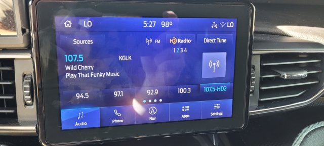

Has anyone installed an HD radio in the standard ST?
I have the 6 speaker system and it does not come with HD radio. Would like to get it added.

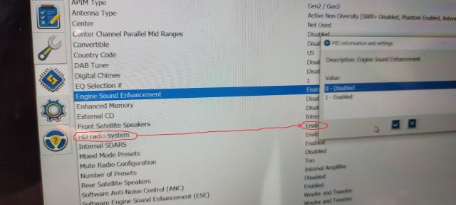

You can add HD Radio to a standard ST radio.
Just need to use Forscan to enable HD radio.
Is under AMC Module. Look for the HD radio System and enable it.
