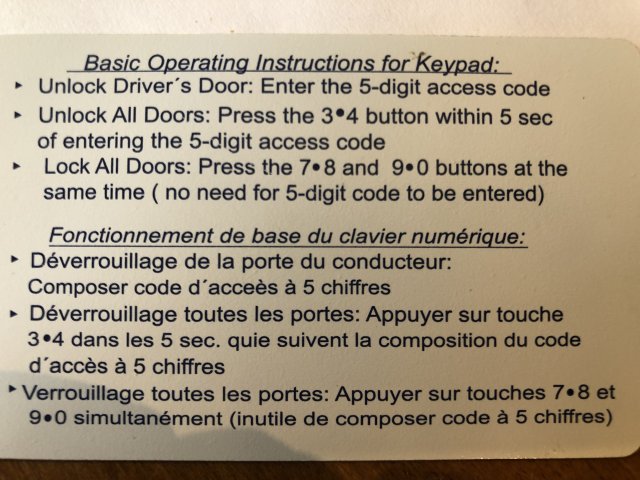

Punch in the dealer code they gave you using these instructions. This is the back side of the Securicode card I got with my ExpST. Hope it helps
Thanks for looking it up, but the five digit factory code is not available, so I can't even do step 1. Bought it used and card was not with the owner's manual and the key job method of retrieving the code is not working and I don't want to screw anything up taking panels off and remove the fuse box to gain access to the code with a mirror.
