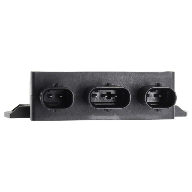

Is this what the front looks like?

^^ Pic was from local ford dealer parts website Part #: 14B291 for $109
Wanted to make sure it was the right part

Is that the complete part number, My dealer says that is the base number for many modules. Not sure if he knows what he is looking for. Thanks in advance to anyone who can help!
115
60
Central Cal
#28
" JX7Z*14B291*E SOR CONTRO "
The above is exactly what it says on my invoice for a 2021 Explorer module.
Hope that helps!

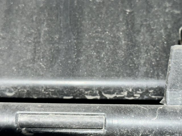

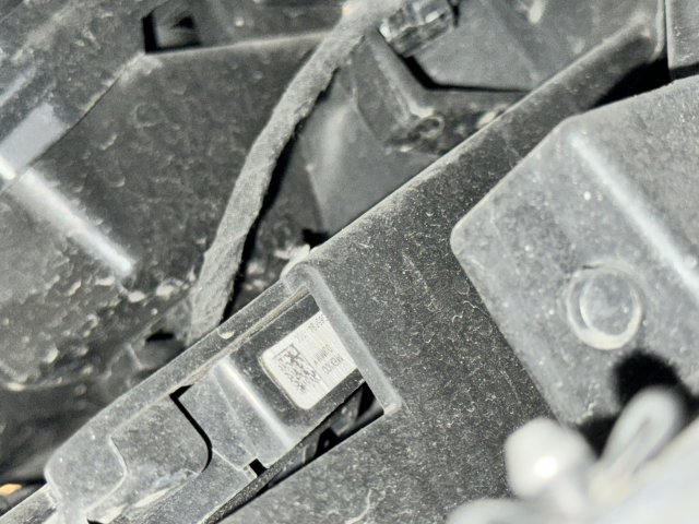

#40
Assuming the sensors and harness are there, yes. The part number I used was JX7Z*14B291*E
I will double check later today to see if the sensors and harnesses is there along with the dummy module.
Part number—okay, been seeing different but similar part numbers for all over the place and some of pictures looking a little different or some lack pictures of them, just wanted to confirm before placing an order.
**edit; updated and found dummy module along with the sensor strips present.
