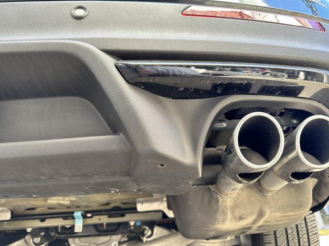

For those with a 2023 or 2024 Ford Explorer ST, go under the exhaust exit on the passenger side. Look behind the bumper cover and you will see the module there with 3 connectors connected into it; also look right beside it, you'll see a tube like part which is the tube sensors for the hands-free liftgate. If the parts are already there then you only need the module to swap it out and FORScan changes! The confirmed and verified part number for that module is: JX7Z*14B291*E. I ordered it through my local dealer here in Canada and only ran me just under $80 new.

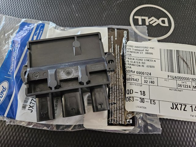

Yesterday I looked under my 23 and the dummy module box was there along with the sensors, so today I ordered the new module from tasca, it was 60 bucks and change. Cost me 78 with tax and shipping. This is the biggest thing I miss from my 21 as I used it all the time.
I Bleed Ford Blue
771
532
23 Rapid Red Explorer ST
#43

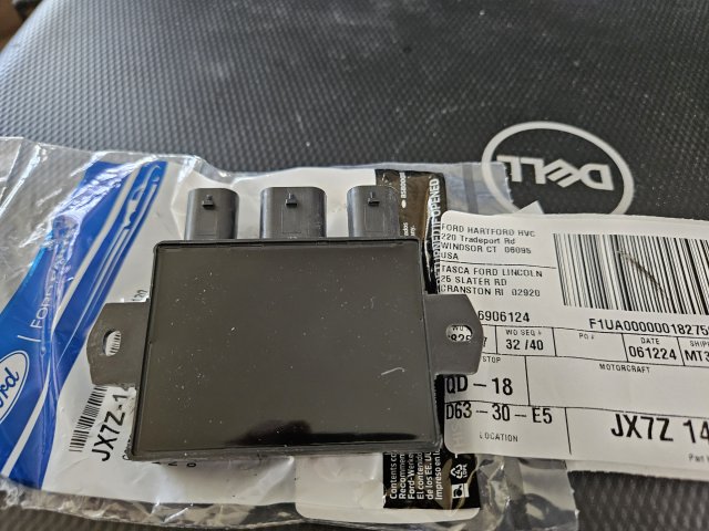

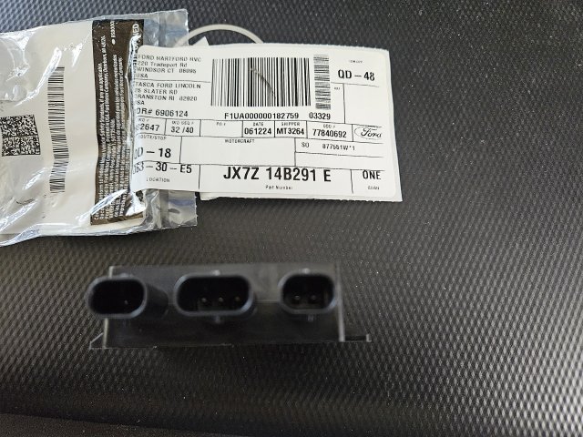

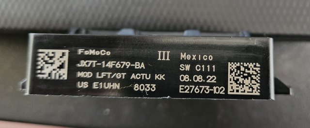

The new module came in today, it is much smaller than I expected.
20240621_122553.jpg 20240621_122559.jpg 20240621_122608.jpg 20240621_122621.jpg 20240621_123412.jpg
I Bleed Ford Blue
771
532
#44
Well I plugged it in and did the forscan changes and nada. I tried using 05 since everyone who has a 23 said 05 works, well it didn't on mine. I'll try using 04 when I go back in. Since I'm tuned, I had to put it back to stock so forscan could read my vehicle, do the changes, then reload my tune. It's kinda a pain in the ass in 95 degree weather with the sun beating down on you.
I would double check the FORScan changes in the first post to double check if there’s any errors which do happen. Once that’s ruled out, I’d recommend maybe changing to 04, see if that helps? You can also do the BdyCM Local Interconnect Network New Module Calibration" under the wrench in FORScan. I did this to mine seeing it’s a new brand new module instead of a used one and it doesn’t hurt anything. Takes about 10-15 seconds pretty much.

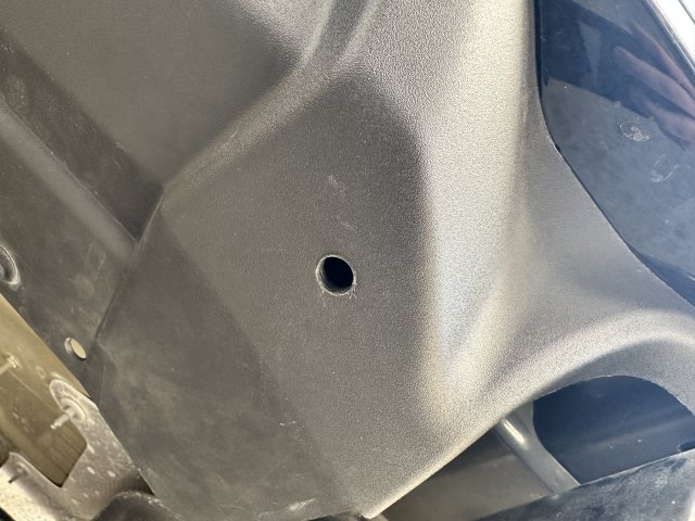

Many thanks to @i8iridium!
Worked like a charm! Needed to do the new module calibration and I drilled a hole in the lower part of the bumper to get at that damn T20 screw holding the module in place.
Pictures of the hole I drilled. Much easier install, can’t see it unless under the car. Might 3D print a black TPU plug but I’m fine with it.
