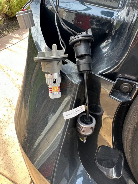

Agreed. The small plastic covers are specific left and right. Also specific with regard to the position. So they unsnap and snap back in very easily as long as the orientation remains the same.
I removed a small retaining piece that takes torx screws. It made getting the larger plastic trim piece off and on easier. It will all be obvious. After the retainer is removed from the inside, you have to pry the front edge of the light assy outward to get the snap to release. Just use your fingers to pull the front end away or if you have fat fingers like me, use a bone tool.
You'll need a socket, 11 or 12 mm a torx driver, #25 I think.
@JohnE is right, 10 minutes per side. Just be careful to not drop the unit against the car.

Just did all of these products yesterday. Super easy to swap out the bulbs. Everything works great and bright, but I wish the license plate LEDs were a little brighter. I might go with diode for that one.

Good choice, I did the same and love it. Amber for turn signals, wicked bright reverse, and plate lamps. Not cheap but well worth it.
