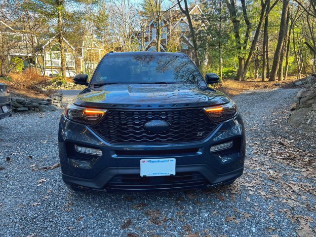

Posting to older thread but trying to put on the Amber Turn Signal Lights when DRLs are on.
I followed prior posts but some reason it still won't work. Curious if any members know what I am doing wrong?
Prior Post Instructions:
726-42-01 x4x4 xxxx xxXX - Sets the White DRL to fixed position, meaning they're dim when the headlight is on, and off when the car is in normal drive mode, daytime.
726-43-01 x1x1 xxxx xxXX - Sets Turn to Turn and DRL
Thanks in advance for any possible assistance.

You don’t need to change any values.
Mark1328
Hudson, MA
2-24 Ford Explorer ST
Thanks for responding but not sure I follow. Are you saying the values are right or the ones present prior to change were correct? In either case neither work on 2024.

send me a pm and and I’ll try walking you through it.
Mark1328
Hudson, MA
Thanks for the offer. On way home noticed in the back of a vehicle it was now working ! Appreciate the response and offer of help.
