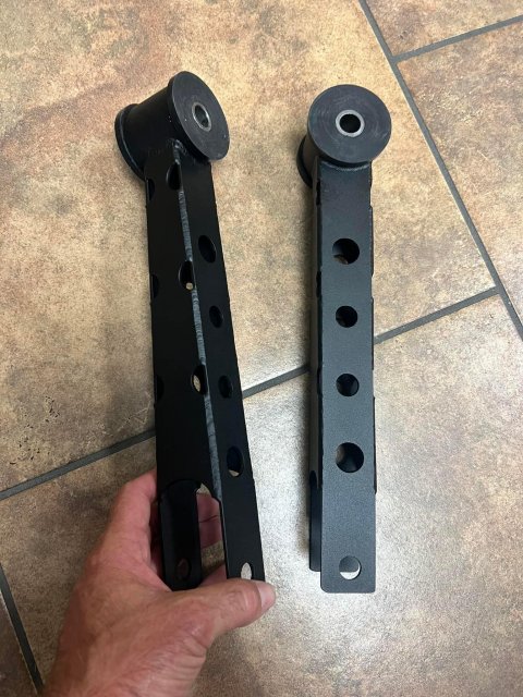

Those are the aftermarkets from FenFab, right? They should have used a higher durometer bushing.

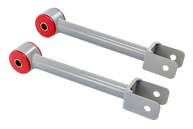

The OEM part does not have those bushings sandwiched between there. Neither does the steeda part. they both have a bushing around a beefy steel collar which is what gets sandwiched. The Fen Fab design simply wont do for our particular application. You might replace the bushings with same thickness washers but why experiment?
All poly bushings have a steel sleeve inside…including FenFab’s. It’s literally the only way they’ll work. The bushing style in Brett’s links is just like Steeda’s non-adjustable. IMG_1610.jpeg IMG_1612.jpeg

If it were me I'd probably look at pulling those links, straightening the sub-frame to the best of my ability (not easy, I know), essentially starting over. I wouldn't reuse those pieces as I suspect they're likely softer. I'd be tempted to try Steeda's adjustable toe links hoping the durometer rating of their bushing is stiffer. I have no idea but a few phone calls may reveal the specs of the bushings used in each application.
The picture of the Steeda parts looks like either the sleeve is super thick or it has a collar on it. It doesn't appear to have a large surface area for open bushing. With Steeda's you'd also get the benefit of more adjustment in setting the toe. Then I'd keep a very close eye on them to see if there is a repeat.
You could of course put your OE links back in assuming their length gives you the reach you need to set the toe. Short of replacing the sub-frame and starting over with OE parts, I'm not sure what else I could suggest.

The sleeve on Steeda's adjustable links looks different than the one in the fixed link pictured above. If the color is consistent throughout Steeda's line then their black bushing is stiffer than their red bushing. At least that is the way it was on their Differential Brace. As I said in the above post, I'm spitballing here.
Question here, is the bushing in between the link and the subframe on the FenFab link pictured above?
Steeda posted a while back that their black bushing is harder than their red…most of the time. Sometimes they’re the same so we can’t go off color alone. At any rate…the FenFab bushing is 10X firmer than the oem. I made a video showing that when I got the links from Brett.
I agree on the wider footprint of the sleeve in the Steeda adjustable links. I think I’m gonna order a set tomorrow because even after straightening the bent spots on the frame it’s still maxed out on toe adjustment and I need some more.
