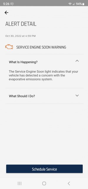

FordPass says it's regulatory and has to do with the exhaust gases. Is this the recall I've heard about or something more sinister?

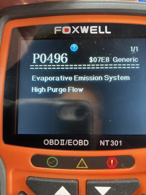

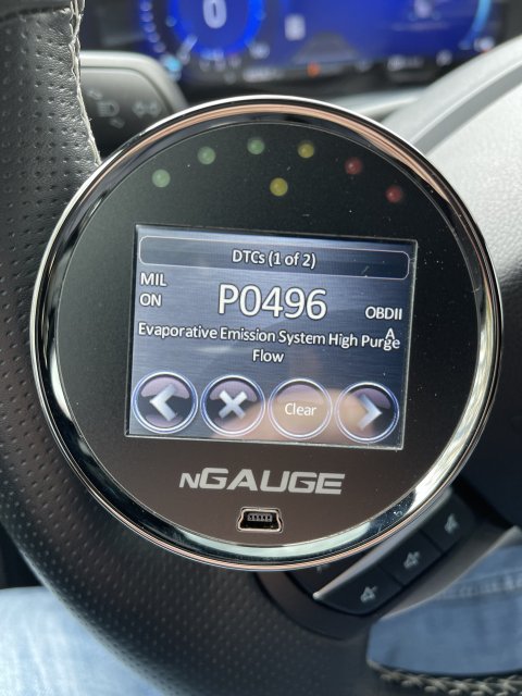

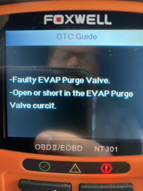

I just got the same MIL Light for Regulatory Emissions and checked the system and found code P0496, evap emission high purge flow. I think it’s the purge valve starting to stick open . After filling up with gas, the vehicle has a hard time starting, just takes longer to start. Picture is attached for reference if it helps anyone. Now, I need to find out where this valve is located so I can swap it out. CC9A56D3-A451-4EB6-9F88-E599CEAFBBA1.jpeg 5B580C48-C842-4A2D-B502-DB62A846AFD4.jpeg

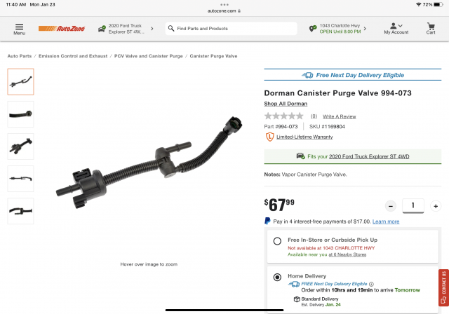

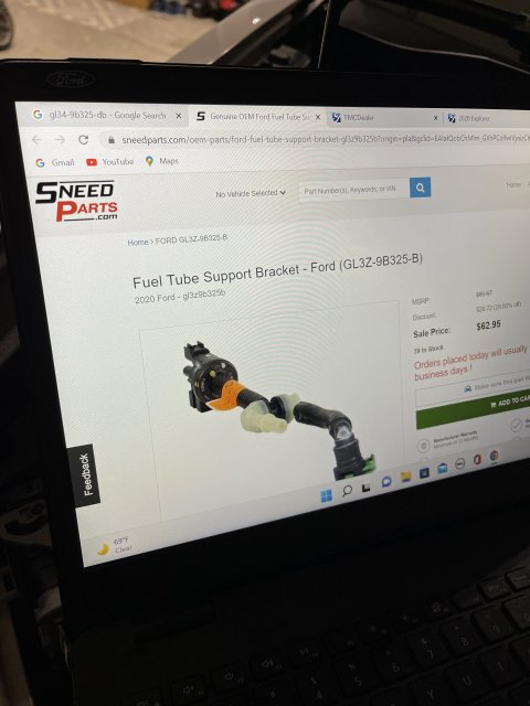

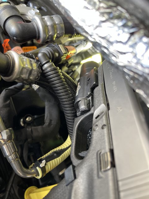

Update for you guys on the Purge Valve. Yesterday my Neighbor and I checked the valve using his Ford computer, he is a tech at the dealership, and found the valve is bad… stuck open. We had to remove it to be able to get the correct part number as the part Ford lists is only a hose and not the valve assembly. I have attached two pictures, one is the valve I ordered which has the correct part number and the second photo is where the valve is located on the engine. It is a pain in the rear to access but not impossible. The part number is the important thing, if you need this valve and the dealership or repair shop is going to order it give them the number in the picture, and Yes, it is a Ford part number. The part location is where my light is illuminating FYI. Hope this helps AF9C69A5-D62E-41D2-872D-AC641586D72C.jpeg image.jpg

Good to know. On the other hand, myself being a competent operator of firearms, if this is how you use the flashlight you are just increasing unnecessary risks for a negligent discharge. I am sure you could have found something better to use.

Peterfor, you are correct on safety, although chamber was clear and empty mag… I just had it on the bench ready to clean and needed a light to show the valve, my overhead garage lights are lackluster on output.

The P0496 just popped up in my ST and it only has 19,700 miles on it. Good thing is, my three years is up this June. Considering the location. Maybe it is easier to drop it off and let them do it. However, I may attempt it. I hate leaving my baby at the dealership. The last time she was there. Had the rear camera replaced along with the PCIM and they had it for a week and a half!! Lack of warm bodies to work on them. so they say!
new jersey
2020 explorer st
I was just able to get one
GL3Z-9B325-B
from amazon for 24 bucks!
