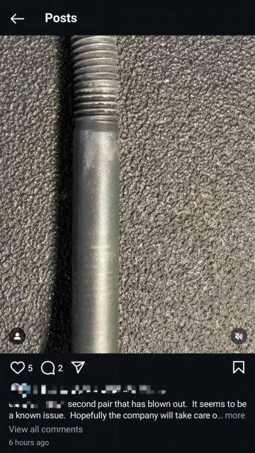

I just saw a failure of the Steeda front pinion bushing on social media. I assume this is what you're referring to? @2020FordRaptor Do you have experience with these failing?
Yes it has become a hot topic. Apparently a lot of them have failed on people, I was never a fan of them in the first place because they didn’t do anything and they cause a lot of NVH.

The bolts holding the brace to the subframe are known to snap. It works well as long as it doesn't break, but I've seen quite a few snap.

IMO it wasn’t well designed. It was designed to look big and beefy and they know the average guy will go for the new, shiny “bigger is better” part…even though it made things too stiff and started snapping mounting bolts. Same with the pinion bushings…they were never needed. I believe they were a “solution” to a self created problem….stiffen up the front and their brace would stop breaking bolts. Except you can’t hammer on a poly flange like that and expect it to live so now those are failing and the diff is moving so much it’s bending bolts and breaking the diff cover.
At MOST…a 4 bolt car could use the JXB inserts. A 2 bolt car the JXB insert and the ID Speed diff brace. The rear diff does not need to be mounted solid…people have been sold a bill of goods. Now that said…the subframe lock outs are worth their weight in gold.
