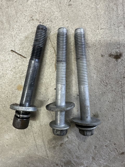

#82
Just a pic showing thread markings. The upgraded bolt on the left was removed from passenger side mount with JXB insert. The other two are OE bolts from passenger side and driver side respectively with no JXB inserts. As anticipated, the bolts with the JXB inserts do not thread into the diff cover as much. Whether this is a concern s anyone's guess.
