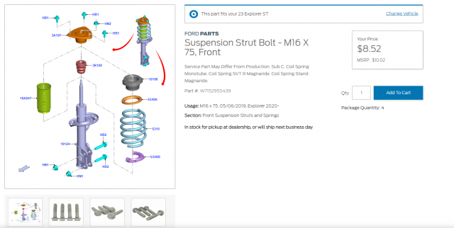

When installing the front springs best to use non splined (New Service) HB2 bolts as recommended by Ford, they allow freedom of movement for front camber adjustment, also don't forget to have your suspension bushings "Clocked".
A competent shop will know to do both.
Those non-splined bolts don’t allow any appreciable adjustment. Tried that a long time ago. Easiest, cheapest way is to just slot the upper holes in the strut a bit with a carbide bit. I’m not a fan of camber bolts but I hear those exist as well. Most cars will sit -.8 to -1° without anything being done which is fine.
Thanks for the good input, I have lowering springs, sway bars and a strut tower brace to install, and then will perform the alignment myself. Was putting off installing because I could not see a clear path to the front end alignment due to the splined bolts, I thought the non-splined bolts were the answer. Will start installing the parts tonight.
